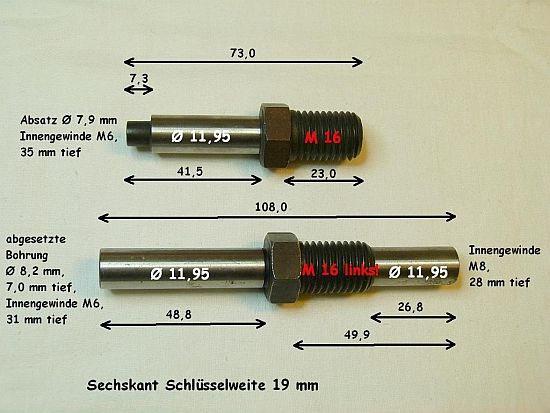

For the cost of the HUB I am not sure. But I can design it (I am a product designer), and ask a prototype factory to make it (maybe around 200-250 euros, I have no precise idea actually, but this part is not easy to make). I am not sure also which kind of aluminum is used for hubs.

So I think I will buy front and rear light, buy a dynamo as the example you showed me, and see if in the future I can make the hub. But i am afraid the lengh of the hub will be a problem.

This shows the dimensions of the axles (upper = front); you may need it for designing a hub.
