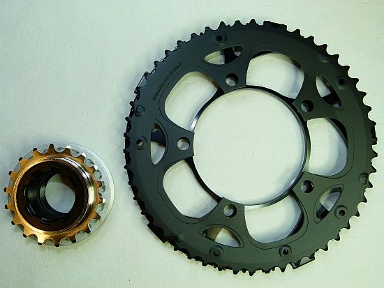

First; the installing would require a complete change of the drive train from belt to chain.
Next step would be to figure out how many teeth maximally are possible at the rear.
I know that 18 teeth fit, but I'd suspect - and wish - one could go higher, maybe up to 20T.
So - now one could start playing around at the front - possibly we could use here 56 or 58 teeth.
By using a chain there is also a certain chance of adjusting the chain line a bit left or right,
this may also help to get around the bottom tube.
Below a quick shot to illustrate on which base I drew my conclusions above; the parts to the right are a standard BCD 130 50 T chainwheel, laying on the original Strida 80 T beltwheel.
Left a standard pulley with 18 teeth, laying on a genuine 30 T belt pulley.

1st EVO gear: 78,7 (virtual) teeth -> lower than single speed ratio
2nd EVO gear: 100 (real) teeth -> same ratio than single speed
3rd EVO gear: 125,7 (virtual) teeth -> higher than single speed
1st efneo gear: 100 (real) teeth -> lowest ratio equal to single speed (too high for a low gear)
2nd efneo gear: 143 (virtual) teeth -> a bit higher than 3rd gear on EVO (should be manageable)
3rd efneo gear: 179 (virtual) teeth - > much higher than 3rd gear EVO (too high to pedal)
The inside gear ratios of the efneo drive (just like on Schlumpf/ATS drives) require explicitly the use of a smaller beltwheel, with 80 teeth are the efneo tooth numbers:
1st efneo gear: 1,0 x 80 = 80 (real) teeth -> lower than single speed ratio
2nd efneo gear: 1,43 x 80 = 114,4 (virtual) teeth -> a bit higher than single speed but doable
3rd efneo gear: 1,79 x 80 = 143,2 (virtual) teeth -> a bit higher than 3rd gear EVO
