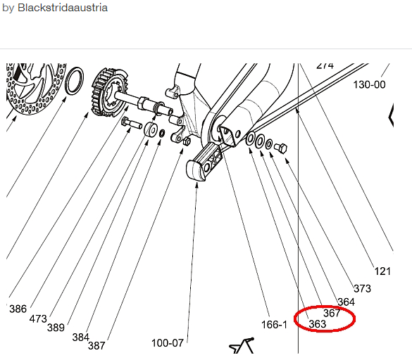

The 373 bolt is currently just a bit loose, but still I can't remove it. Should I apply more force?

Winfried wrote:The 373 bolt is currently just a bit loose, but still I can't remove it. Should I apply more force?
No, not more force please :|
I guess you mean the parts below the bolt's head are loose and the head is tight.
That would be for me a sign of a damaged rear joint.

They don't feel loose, but regardless, I can't loosen the bolt/head as it's very tight.
How can I remove the bolt to check the state of the parts below (cup spring, washers, frame) ?

Bolt 373 is originally glued - it is now very hard to tell why you can't remove the bolt.
Either it is just the glue still holding the bolt - or, that would be dangerous, maybe there is rust in the thread. You are now of course in danger to break the bolt...that would be pretty bad because in that case has the complete axle to be replaced (that again means complete disassembly of the rear part).
I would now try to heat up the bolt's head a little bit, not with flame but with electric heat gun.
There is no other way than that of removing 373 first - it is impossible to get "from the other side" because the axle (at the same time axle stump below 373) goes through the bottom tube.

Postby Blackstridaaustria on Mon Jul 09, 2018 4:09 pm
Do not break the bolt if possible.
Can you tell:
Is it possible to turn the washer and/or cup spring below the bolt's head by hand?
Try that with the bike laying on the left side.
While you try to turn the parts with one hand, use the other hand to pull the right crank gently upwards and downwards - crank in 90° position related to bottom tube (to generate torsion of the bottom tube).

- The behaviour "occuring while applying more load" - does match exactly to the rear joint issue.
- The sound matches, too.

Winfried wrote:Hopefully — since it's a cheaper operation —, it's the rear hinge that's to blame (€30 parts + 1/2 hour of work €25 ~ €55?).
Much cheaper as long as you can get rid off the 373 bolt without breaking it.

In the case they can't find an issue on the drive I'd recommend you beg for replacing of bolt 373, washer and cup spring.

After a €50 tune-up, it's now perfectly silent, save for the inevitable ratchet sound from the SA gearbox.
You were right: It was indeed the rear joint. The mechanics used vaseline instead of a new nylon washer, though.
