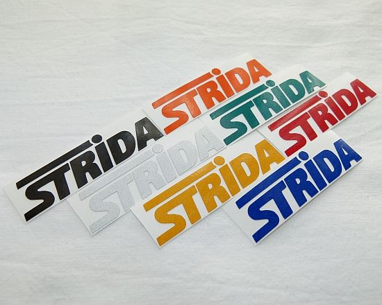

All shown decals were made with a Silhouette Cameo cutting plotter, back then only in black or white (silver) foil.
http://www.silhouetteamerica.com/

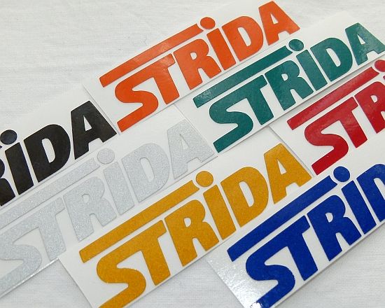

Recently I've got new reflective sheets in seven colors (four more are backordered),
the first results are not that bad I believe...
Size: 60 x 17 mm - the word "Strida" is a bit larger than that of the older "Strida.com" lettering.
The most important difference of those stickers compared to the original ones is the count of single parts:
Even the i-dot is an extra piece; so there are in sum seven parts - the original sticker is just one piece!

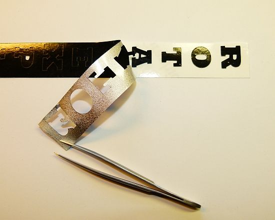

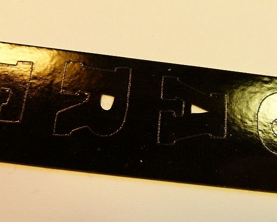

Most work did the cutting plotter, the outline contours were cut in the reflective foil.
The backside (adhesive protection foil) should be left intact; therefore the cutting knife has to be adjusted exactly for each foil type.
Step 2:

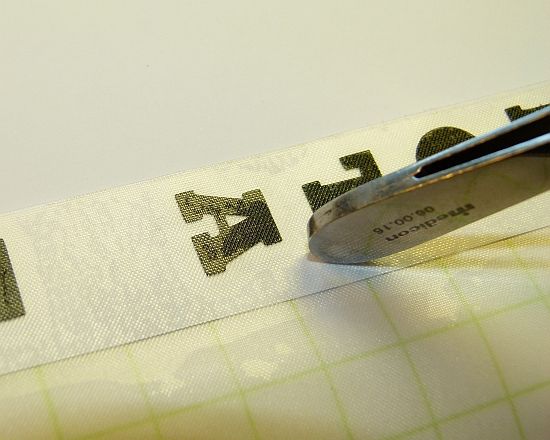

The unwanted material must be removed manually; for little chunks (inside of R, D, A) will be a needle very useful.
There is a special expression in German for the withdrawal of the parts outside of the letters - "entgittern".
I couldn't find a correct translation but I mean "de-caging" would make sense...
However, sometimes the letters - especially the i-dot, or corners - like to peel off the backside, together with the "cage"!
That must be avoided; a toothpicker or maybe a stylus will be helpful to keep the letters in place while "de-caging".

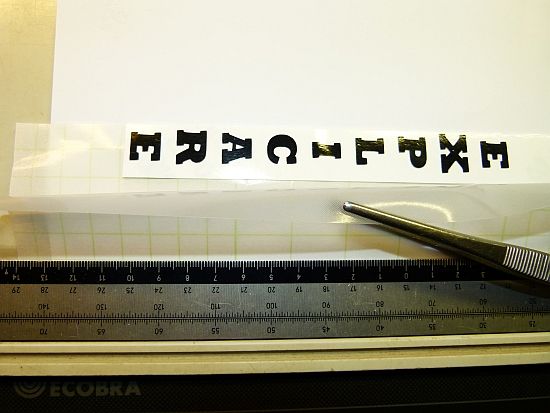

Step 3:
Transfer foil (weak adhesive) will be used to secure all single parts in their correct position.
It should be applied straight and plain, without tension in any direction.

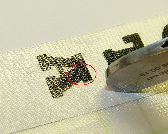

Due to the weakness of the transfer foil adhesive it's very important to rub the foil painstakingly onto each decal area
- otherwise it might fell off while removing the backside protection!
For example; the oval signed area at the right side of this "A" is connected well to the foil, but not the rest.
(The rubbing tool is the rear end of a big tweezer.)

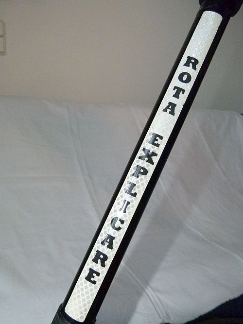

Last to do is the removal of the backside and the applying on the desired location,
here additional to the Strida front reflector:
Regarding (at least 3M and Hi-Viz) reflective foils I want to add a warning at this place:
The adhesive of these foils is indeed strong, that means (later) removal is really nasty.
And there is exactly one chance to place this stickers properly; corrections are not possible!

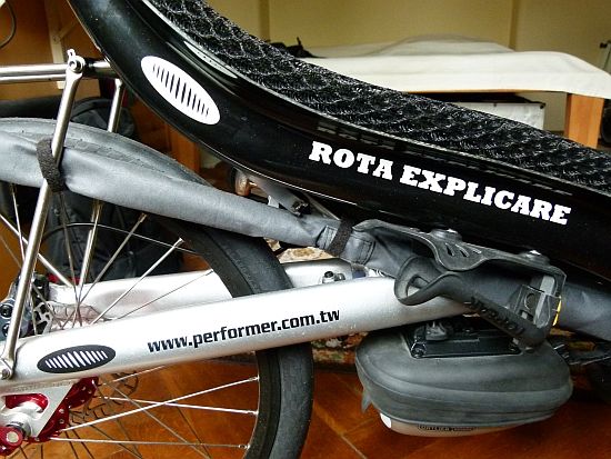

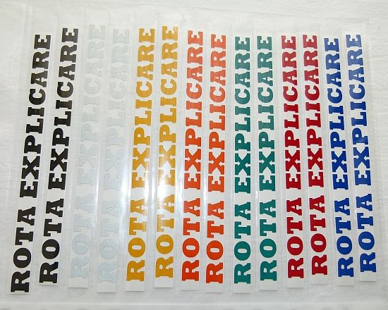

The lettering "Rota Explicare" is in fact the name of my friend's store; we're planning to provide some selected bikes with these stickers...
...and perhaps more by request, could be the initials of the new owner or anything like that.
Unfortunately are my artistic skills very poor, but with the Silhouette cutting software it was actually easy to create this oval "air intake" design:
