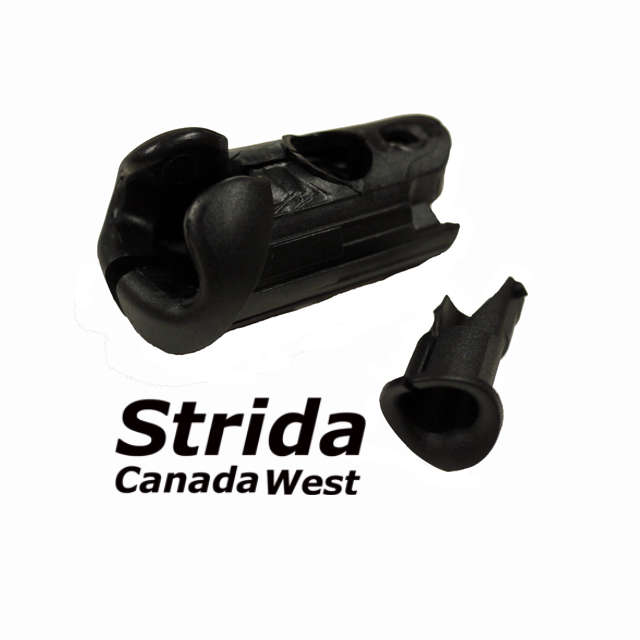

Please scroll three posts up and read on here, too:
Re: Ball joint unscrewed
It’s a lot of work, but I’d replace the ball “pan” 215-11 and 215-12 as soon as possible - because there shall be
[size=150]no compromises in security matters![/size]
http://stridacanada.ca/?product=strida-ball-joint-socket
Thanks for the move, I will probably go this direction and replace my ball joint.
