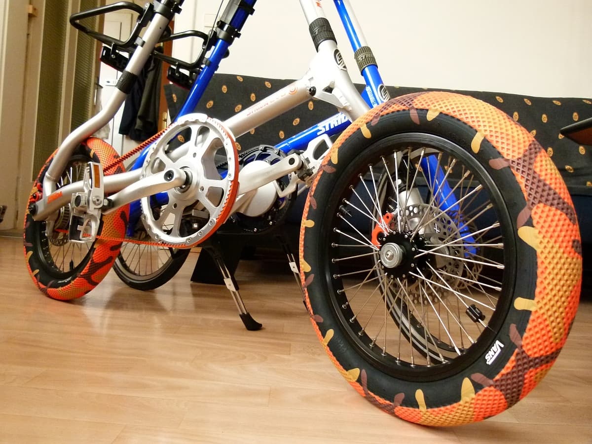

Dear readers,
some posts mention the tyre
MAXXIS Hookworm, 16" x 1,95 (ETRTO 53 - 305)
max. pressure: ~ 8 bar (!)
(Shown is the more common 20" version!)
(As far I could figure out, this BMX tyre is(was) used mostly for trikes, recumbents and trailers.)

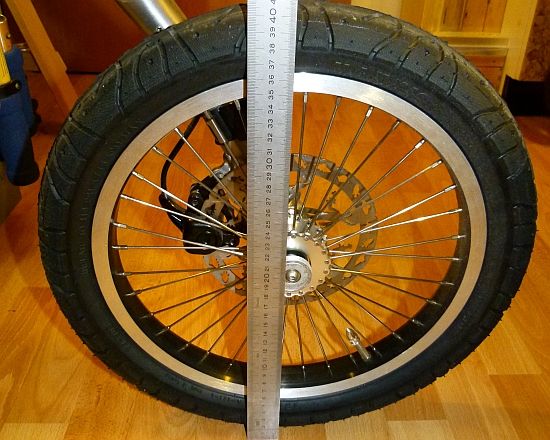

What is the inflated diameter?
I know they have a very tall sidewall on the 26x2.5" size but am curious how big the overall diameter is in this 16x1.95 size.

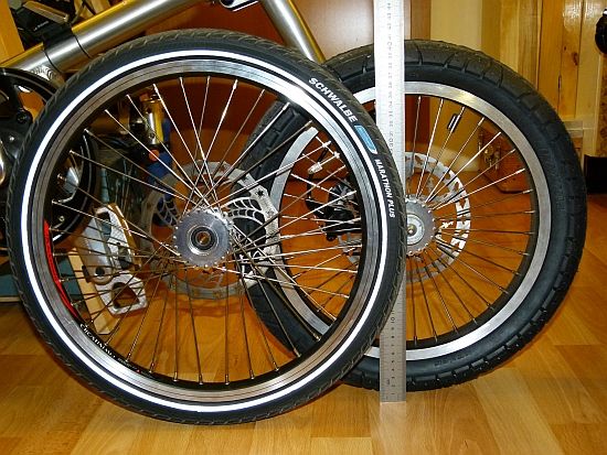

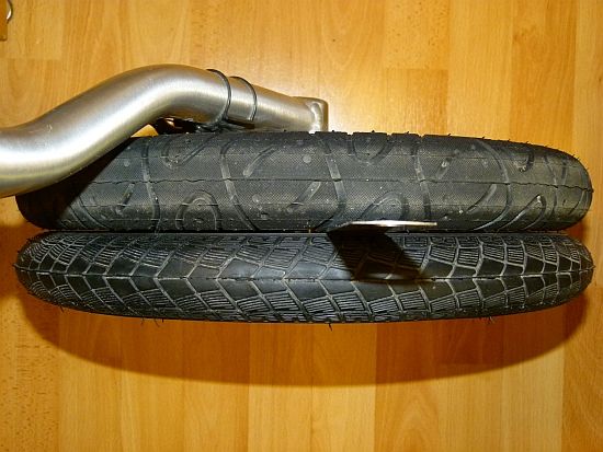

The diameter will be a few mm’s below the 41 cm mark, here compared to 18 x 1,35" tire size:

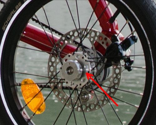

As mentioned already at the forum (examples below), you might have to solve two known problems;

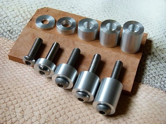

  • the magnet (mount) has to be modified for proper function,
  • and there are sometimes tire mounting issues.

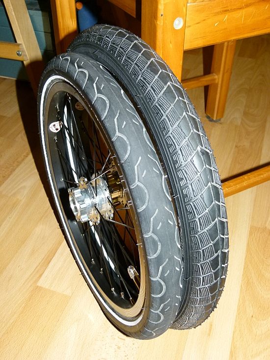

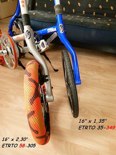

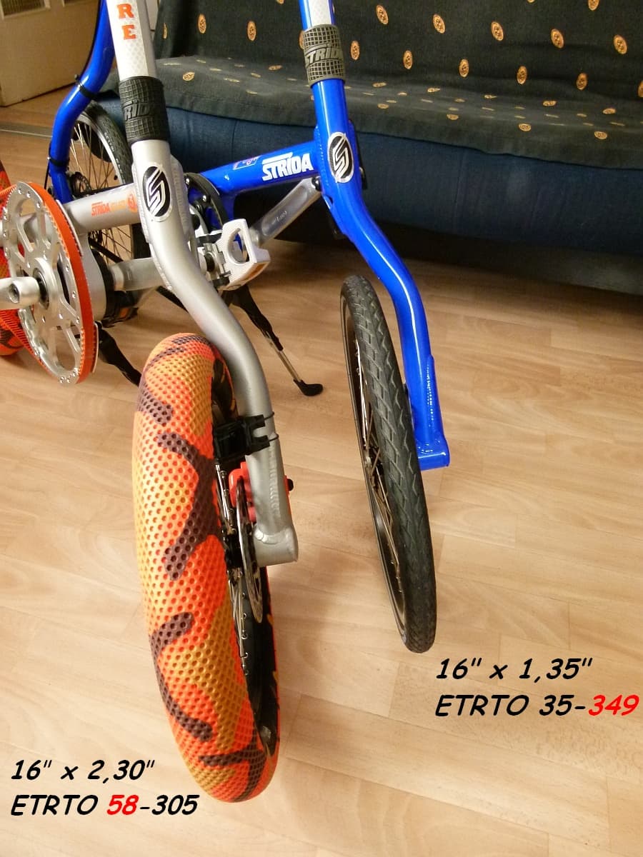

    (Short explanation, out of experience: Original Strida 16" rims do not really good fit to extremely wide tires. Therefore it is occasionally difficult to get the tire in the correct position all around of the rim’s bead, even with a perfect trued rim would such a tire run out-of-round.
    If that happens, look for an air compressor and this:
    http://www.schwalbetires.com/accessories/helpful_tools/mounting_fluid :wink: )

I’m highly interested in the magnet modification, a prototype of “wide-tire-kit” was already made:
Aluminium spacers + stainless steel wheel bolts in steps of 5 mm

Actually I was the guest asking the diameter.
I am trying to make my 5.0 faster but don’t want to buy the 18" wheelset because I want the comfort of the fatter 16" tires.
Out of curiousity, what is the diameter difference with the 18" Marathon Plus?
Any idea what the diameter of the 16" Big Apple tire is?
Bigger or smaller than the Hookworms?
I want to find the largest diameter 16" tire that fits my 5.0 frame.
I am even willing to remove my fenders.

The diameter difference of 18 x 1,35" to 16 x 2,00" is nearby 2 cm (42,7 - 40,7).

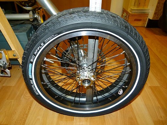

Diameter of Hookworm and Big Apple are in fact almost identical,
the fatter look of the Hookworms is caused by profile depth and shape.

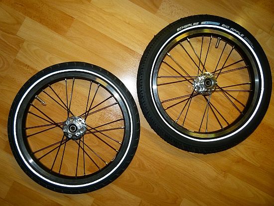

Big Apple (front/lower) vs Hookworm:
Schwalbe Big Apple compared to Kenda Kwest 16 x 1,5", both on original rims:

There is also a third problem, next to weight and space.
We found out later that hookworms do not match to the original rims, it is impossible to mount them on these.
The only tyres which do fit are the Schwalbe Big Apples - even mudguards can be used.
For extremely wide tyres there are other rims and more tricks required :wink:
