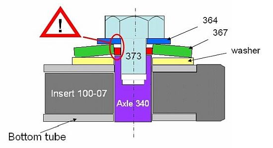

Yes, that is a solution I was thinking about. If you want to keep the same preload, then you have to put a small washer of the same thickness as all the hardened washers you are adding, between bolt 373 and axle 340. Then the spring built-in length will not change. You just have to make sure that bolt 373 is screwed far enough into axle 340. If it is too short, use a longer one.
I now see that my sketch was wrong :imp:
I thought washer 364 was centered on axle 340, but it is actually clamped between nut 373 and axle 340. So if you add a washer under the cup spring you need to add another washer 364 but of the same thickness to keep the same spring preload.
In my case, I want a higher preload, so I will not add an extra washer 364.
Calm down, most of us will not have realized that :smiley:
The drawing is still very good, I was quite unsure about this detail and therefore I wanted to disassemble a few bolts at the weekend.
Seems that we need in sum three washers to reach the target of a fully functional rear joint…
I’m also quite unsure how to proceed with this post because it will belong to several known issues of the rear Strida region. To merge the posts is not that good, I think…maybe pin this post and edit with links to the other posted problems…
Well the proposed solution is less simple than I thought: the distance ‘X’ is only 2mm. The cup spring thickness is 1.7mm, so it can only be compressed by another 0.3mm before being completely flat. It is not advised to push a cup spring until it is flat as the stresses in the spring become too high.
Adding a washer under the cup spring is therefore not advised, if the washer is about 2 mm thick (like the stainless steel one I found in a DIY shop), the cup spring will not be centered anymore and bolt 373 will not be screwed against axle 340.
Overtightening the bolt will damage the cup spring.
Adding a third washer between axle 340 and washer 364 is not ideal because it will not center perfectly and the inner edge of cup spring 367 will not be well guided.
On my bike, I replaced the soft steel washer 364 by a stainless steel one, which seems to be a much harder material. The original washer was quite deformed/worn out, and my first impression today is that the rear wheel swing movement has been reduced by almost 50% by bringing the preload of the cup spring almost back to its inital value.

Yes, perhaps not ideal…but if the thickness of the third washer is below that of the cup spring and the outer diameter very close to that of the axle it should work, I believe.
The third washer should fit inside of the cupspring; imaginable as some kind of axle elongation - shown in red color below.
(I’m here also thinking about a method for easy retrofit - a longer axle, like mentioned by Xentrax here, would be the better solution, but it would also need much more effort for exchange.)
Hope you don’t mind that I’ve used your image for illustration:
I agree with your ‘3 washers’ solution. However, for a retrofitting solution, the difficulty will be to find standard stainless steel washers with the proper dimensions (diameters and thickness).
You can of course order custom washers made by laser cutting or etching but it could be quite expensive, especially if you have to buy the raw material in large quantity :confused:
