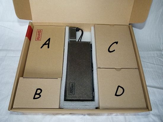

Most people don’t like to buy a pig in a poke; here’s how the kit looks:
Battery inside bag in the middle of the box,
drive and accessories were packed in four smaller boxes

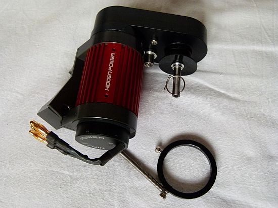

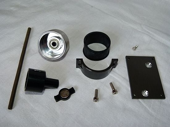

Content box A: Hp drive + mount (shown here the Strida version)

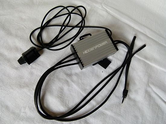

Content box B: Controller
Content box C: Roller and additional parts

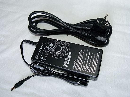

Content box D: Charger
Kept that short; higher resolution and much more pics of both versions are here:
low resolution
high resolution
The differences to the Standard kit are
  • Mounting plate rotated
  • Shorter roller arm
  • Added spacer
  • Cable lengths
  • Shorter roller axle stump (freewheel)

Controller 200
Motor + mount (Strida version) 750
Motor + mount (Standard version) 785

Charger 310
Power cord 180

Controller to battery connector 15 (10)
Controller to motor connector 37 (10)
Controller to throttle 135 (135)
Controller to PAS sensor - (40)

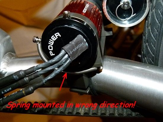

Actually I need to clear something first:
I did completely misunderstand the function* of the drives mechanic and mounted therefore the recoil spring in the wrong direction!
As there was no “real” application guide supplied I have a small excuse…
(The “guide” you can see in the high res album is actually just one sheet of paper, containing battery hints.
According to the sales manager was the translation of a detailed guide finished just one day after our purchase.)
So - naturally - there was some trouble in the beginning.
Once figured out how the parts belong together it’s very easy to mount the drive.
The mechanical parts are obviously of high quality and fit perfect.
Also noticeable: There are two different mounting plates; one for 16 and one for 18 inch.
[size=150]*Function[/size]

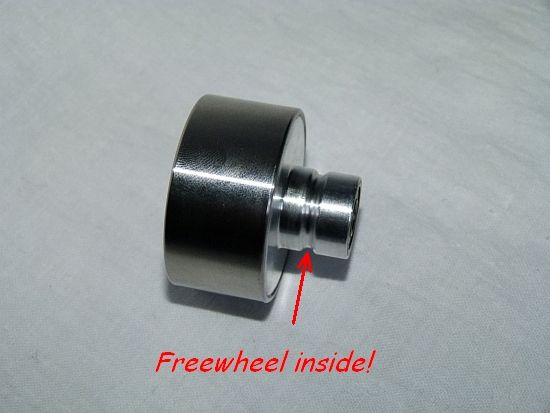

The roller is in steady touch with the tyre because the recoil spring is pulling upwards to a not defined position.
(Not defined because the roller - and the arm - can be rotated easily due to the weak spring.
Said in other words: The arm can “float” above tyre/rim ups and downs.)
So, if the motor is off, will the roller spin - but not the belt in the drivetrain to the motor because there is a small freewheel inside the roller axle stump!
Amazing size…
However, the spring is weak, therefore is the additional friction of the roller very low.
Once the motor is turned on will the freewheel engage, the roller bites into the rubber and the arm is pulled to a defined position.
Defined because there is an adjustable (on Standard) or a fixed (Strida) arrestor which is limiting the arm’s movement.
In it’s upper position is the roller pressed strongly (several mm’s) into the tyre - to achieve high friction for the motor torque.
Switching off the motor will disengage the freewheel, the arm will rotate clockwise and the roller-to-tyre pressure released; we’re again in the - still touching, but with less friction - undefined mode.

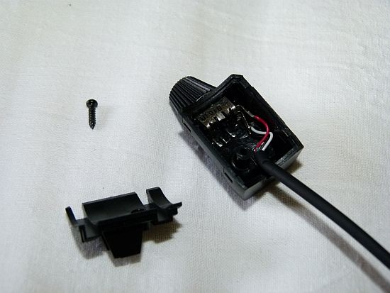

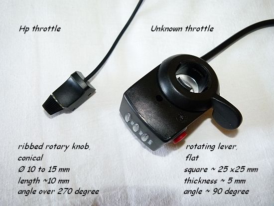

    1. Dumb throttle
      Below the HP throttle compared to a common e-bike throttle, please note the dimensions (and working angles!) and especially one crucial detail:
There is no recoil spring foreseen in the HP version!
That means if you let it go, the speed control knob will stay in it’s current position until it is turned back manually to zero.
The knob does not automatically return to zero.
Out of security concerns, we mean that a speed control without automatic switch-off will be much too dangerous for the average customer.
In the present configuration, neither Mike nor me would sell this kit to anybody. Sorry. No way.
(Searching the web for an alternative throttle I had to notice that the use of a simple potentiometer seems not common. All found replacement throttles are using a different, contactless system with magnets and Hall sensors.
I’ve noticed also that the HP throttle is far away from being proportional - the motor will spin with full speed at an angle of maximally 90 degree, more than 270 are possible with common potis.)

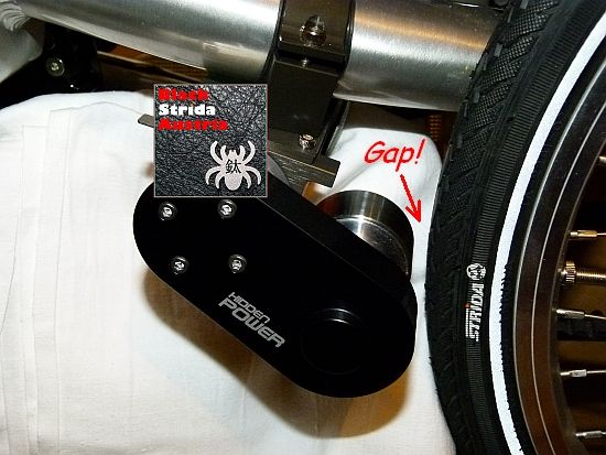

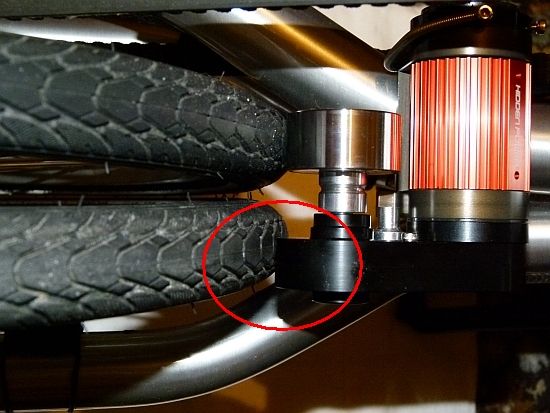

    1. Folding issue
If the Strida gets folded will the roller arm touch the front tyre - and act like a brake while pushing “her” forward, the steady touching roller doesn’t make that better.
Strida insider know it: “You shall not pull her”, but that’s sometimes necessary to arrange the bike in small places, with the arm (which is pulled in direction to his defined position) locking the front wheel it is impossible to pull “her”.
More for that at the end of the post…

    1. Brake switches
      Several interested people mentioned the importance of additional motor-off switches inside of the brake levers.
      We’d suggest to add this function for security enhancement and also to compensate the - technically caused - idleness of PAS systems.

Different in the folding issue:
By modifying one original HP part, adding two custom parts and a metric bolt I’ve created a simple locking mechanism.
Principially said: The drive became a second defined position; arm and roller are arrested in a certain position a few mm away from the tyres - and the wheels are free!
Of course, there’s no remote control - engaging works by turning the arm about 10 degree clockwise, disengaging by lifting a little lever for ~ 2 mm.
Neither material choice (Titanium, Brass & Steel), shape nor the mechanical function are perfect, but it works very well.

So If I summarize :
1- The HP throttle need to be changed by an “automatic turn back” throttle.
Too dangerous with the actual HP throttle.
The brake switch is also a really good idea : I think they aren’t so far…
Perhaps by setting up a cable to bypass the acceleration throttle with this brake switch, it would solve the problem quickly.
The brake switch system should be adaptable to Strida brakes easily.
2- Folding issue
What a pity!!! :frowning:
Chris: Are sure we can’t do anything to solve easily this problem?
Is there a way to move a little the installation of the HP kit to improve the movement of the wheel (and prevent the blocking effect) ?

1- That might work, all I know so far is that the motor won’t run if there’s no poti connected :wink:
(Once I’ve got a spare controller…you know…)
Imaginable would be here also that they want to imply the brake function later in the planned electric Strida (Ming/Hiddenpower cooperation).
2- Indeed…
Btw, the suggestion we got of HP - to use mudguards - seems not very useful for plastic fenders,
because they will bend…and interfere again with the tyre…
Please take a look downwards to your bottom tube and notice the two bends between rear wheel and bottom bracket.
The clamp for the drive is mounted close to the middle of the first bend.
It’s impossible to move the clamp along the tube without changing the angle of the drive axis - not good!
Even if you would compensate the angle issue by a custom mount adapter plate
(which is surely possible, but senseless)
there will be no difference in the original two position (one certain, one a bit insecure becouse of touching an untrue wheel) function.
And if you move the drive far (that means in this case a few mm’s!) away from it’s original defined position -
then it will not work properly any longer due too much (or less) pressure on the tyre!
The drive must be in a certain position which is given by:
  • The arm length
  • The roller diameter
    for the length, and sideways by
  • The distance rings of the motor
  • The length of the roller axle
That means otherwise the longer arm and the longer roller axle of the Standard version might match…
so far I’ve no idea what’s the reason for the shorter Strida version arm.
Did you also notice that all the older HP + Strida pics are showing the longer arm?

And btw - throttle - which type do you (and Kepler) plan to use?

I was going to leave the thumb throttle and controller attached, was thinking thumb so I keep the awesome factory grips…

Your wish is my command :smiley:
  1. A thumb throttle WITHOUT recoil spring will be anyway unsafe.
  1. The PAS System with just ONE magnet will be lame and imprecise.
  1. In folded position can the Strida not any longer be rolled along, the belt housing will interfere with the front wheel.
  1. Many customers are asking for brake switches.
