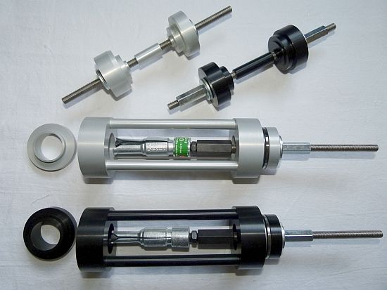

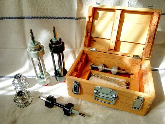

Another update regarding extraordinary tools;
(Tools of/for freaks :sunglasses: )
That’s a set of custom pulling devices for usual bearing extractor tools like the above mentioned, chiseled out of full aluminium rods (Ø 10 - 60 mm).
They’re intended to be used alternatively to a slide hammer for driving of the extractor tool.
(If anybody is unsure about a slide hammer’s function please google for “blind bearing puller” and “slide hammer” :wink:)

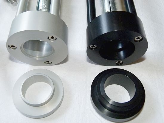

Via adapter rings they are matching exactly to Strida 18" hubs,
the black anodized set for rear hubs and the silver one for the front.
Axial ball bearings were used to reduce friction below the pulling nut.

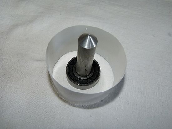

The smaller, barbell shaped parts are pushing devices, these are intended to press the bearings back into their place.
Advantage: Due to the consistent area of support are damages of the hubs and bearings most likely impossible.
Disadvantage: The shown tool set will fit to 18" hubs only; for 16" hubs, bottom bracket and the bearings of the pivot pin would additional adapter rings be required. (And of course different pushing devices too.)
The initial reason to create these devices was - weird but true - the wish to anodize the hubs:
All Strida hubs were delivered with built-in bearings…
Usually, anodizing companies do not accept foreign material in their baths,
on the other hand would the acid bath treatments surely damage the bearings - so they must be taken out anyway.

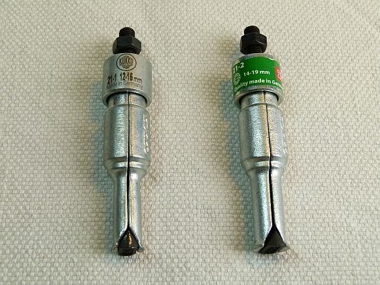

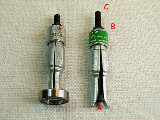

And how does a (blind) bearing extractor work? some might ask…
Inside of the two “grab hook” halves of the bearing there is small cotter A, it’s connected to a bolt C.
Tensioned via the hex nut B will the two halves be forced apart and grab the inner bearing ring.
Second to last step will be the connecting of the extractor thread with the axle of the slide hammer (or pulling device) by using a long hex nut.
Finally can the bearing be hammered (or pulled) out…done!

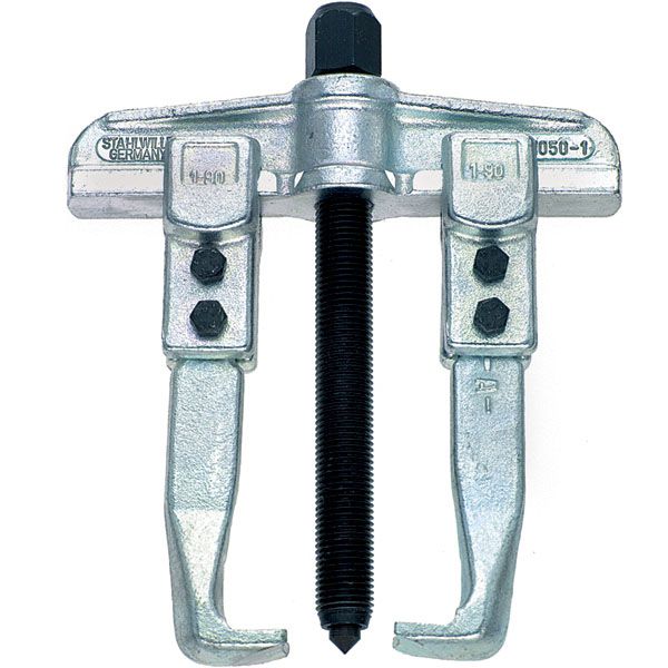

However, if a bearing was pressed onto an axle, you’ll need outer bearing puller, maybe like that:
More info, for example, here:
http://www.skf.com/group/products/maintenance-products/mechanical-tools-for-mounting-and-dismounting/bearing-pullers/external-pullers/index.html
These tools grab the outer ring of the bearing and the pulling force is applied to the axle.

Exactly for that purpose was above tool kit created; to retract all bearings from (18 inch) hubs.
Black puller: rear hub, belt side bearing (right)
Black puller + black adapter ring : rear hub, magnet side bearing (left)
Silver puller: front hub, magnet side bearing (right)
Silver puller + silver adapter ring: front hub, disc side bearing (left).

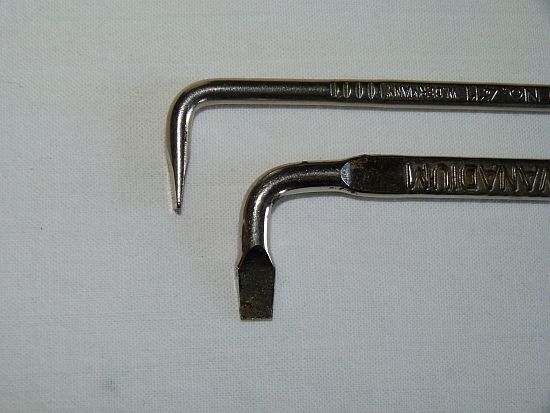

I’d try to apply first any rust treatment solution/thin oil for a few hours,
maybe there’s a chance to loosen the beasty bearing with an angle screw driver?
Also called offset screw driver, preferred a flat tip of good quality
I can’t find acceptable pics of the 3.0 brakes inside, but a simulation will do for explaining, I hope.
Situation will look similar to this
Perhaps you can get the bearing this way off the axle?
Would it be possible to place such a tool below the bearing on several positions?
With a bit luck can a flat tip srew driver be used as a lever.
Of course there is always the risk to damage something…

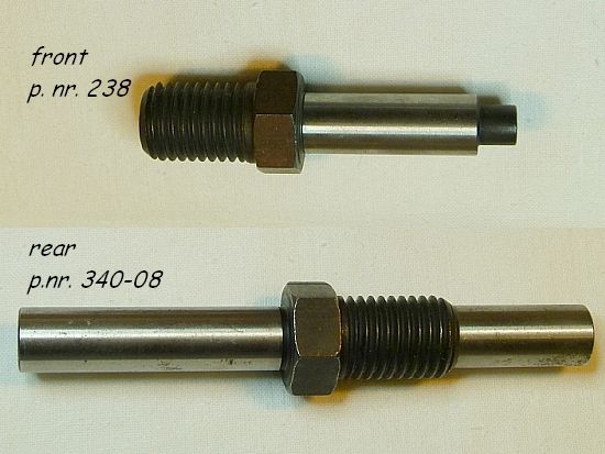

Gladly l’ll try to; please let me first quote myself: Don’t even think of skipping this tube…
(from here: Rear wheel bearings for Strida?) and then start right from the beginning, referring to the parts drawing of the Strida 3 and the old part numbers.
  • Note: The small washer 376 (between magnet and bearing) does have a crucial function.
    By creating a distance (= the washers thickness) it prevents the magnet of touching the outer bearing ring.
    The outer diameter of this washer has to be equal or smaller than that of the inner bearing ring.
    (The magnet must not get in touch with neither hub nor outer bearing ring or bearing cover.)
  • Note also: Once you tighten the wheel bolt 375 you’ll create a force in the bolt’s thread and another one in the opposite direction.
    This force in turn will produce pressure to the washers 165 and 376, the magnet 236, again washer 376 and finally - directly to the inner ring of the first bearing!
And the travel of the pressure force should not be over at this point, usually it would be transferred along through the 237 (or 337 at the rear wheel) spacer and then the inner ring of the second bearing.
Finally you will find a special area of the axle, close to the hex nut.
This area is the counterpart for the second inner bearing ring, it’s diameter is smaller (or equal) than that of the inner bearing ring.
I really hope you can see the fine, round line between the axle stump and the nut, close to the hex shape and vice-versa the thread:
just a few tenth’s of a mm - that’s it!
Skipping the spacer would mean to create very high axial stress to the radial bearing - it would die very soon!
Not really fixed, usually it’s just more or less clamped between the two inner bearing rings.
Had also original wheels where it was slightly moving inside the hub.
No, inner diameter of spacer is slightly bigger than the axle d., spacer’s outer diameter similar to inner bearing ring.

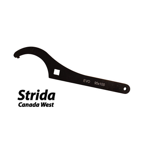

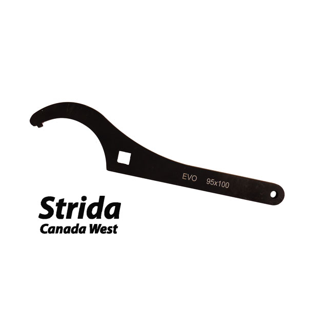

To adjust belt tension at an EVO we’ll need a bigger sized hook key than for the previous 60 mm bottom brackets. For now, it seems that just Strida Canada is offering the correct hook key officially, it can be found here: Strida EVO 95 mm Hook Wrench
This key was equipped with a square hole which is intended for connecting to a torque wrench.
Please note that he recommended torque of 50-60 Nm (according to the KS3 manual) MUST NOT be equal to that which you have to adjust at your torque wrench!
That’s because the square hole is not located in the center of the key; due to the distance the torque must be corrected.
As soon we’ve figured out the exact distance we’ll edit the correct torque amount for this particular key.
