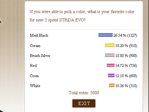

Today 5000 color votes :open_mouth:

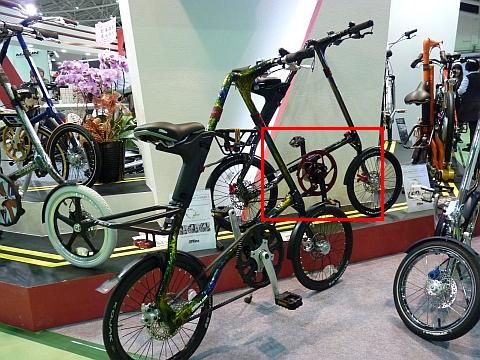

A picture from Strida Taiwan group on Facebook :sunglasses:
the frame paintjob looks really cool but alot of work probably costs more. But do you have any video of them riding it? and how they change gears? This looks like the strida 5 but with a different bottom tube but with a high tech bottom bracket.
I wonder in a year would they be kind enough to sell me the bottom tube with the bottom bracket direct from ming? :smiley: would be an awesome upgrade without having to buy another bike.
one can only dream!

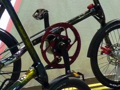

Tooraks Marketing, our local distributor here in the Philippines (Manila) announced that the EVO will arrive in June. I was really thinking about an 18" wheeled Strida by Having an SD upgraded to 18" wheels but I’m worried that the gearing would be hard to pedal on the 2nd gear. So the wait begins. I’ll have to wait for reviews on this specially It comes with an 18" wheel set already The only upgrade to do is change to QRS seat molding.
One thing I don’t like is the new handle bar stem. Seems like there’s a reinforcement welding or something and the new crank arms means you cannot upgrade to the old allow chainwheel or you can buy the wheel only minus the crank arms.

Hmmm, I don’t think so…

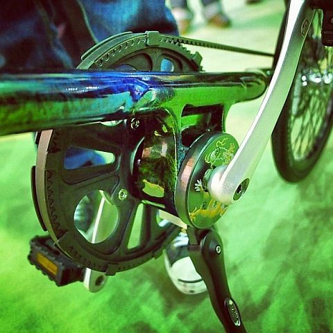

The beltwheel above is definitely not the plastic one… :sunglasses:
Another photo :wink:
Thank you, Amuro! :smiley:
