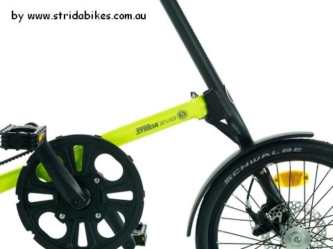

BTW, now (folding the bike) the yellow bar doesn’t go as back as with the older Stridas.
It uses a plastic piece to hold the bar.
Is it due any (unknown) change to the bike?
On the other hand I’ve seen that the locking piece (to mount the bike) has been… over-engineered?
When I received my EVOs I noticed the clip to hold the folded bottom tube, I think it is because of the heavier bottom bracket and the previous friction fit not being secure enough for the extra weight.http://cycleforfun.ca/?p=516
Bill
Sara of Ming cycle told us kindly at the last Eurobike:
The reason for the use of the plastic double clamp is the bigger weight of the new bottom tube (due to the weight of the gear box).
Irrelevant for storing, very important for transporting (pushing “her” forwards in folded status), the plastic clamp is much more safe than the old fashioned locking method.
The EVO still can be folded as usual, but the heavy bottom tube might unlock self-acting and, in worst case, destroy/damage the plastic beltwheel.

I might be wrong, but it looks to me that the usage of this plastic clamp makes the lateral movement of the bottom tube useless. If this is the case, then it would be possible to have a different (=more rigid and more robust) rear wheel fixation system, without Belleville washer. :smiley:
Can the bottom tube of the EVO still move slightly laterally?

It is not a must to use the double plastic clamp, the tubes can still be folded like shown below, correct?
Strida EVO - gearshift instruction video on Strida news page!
Yes you can still clamp it between the two other tubes.
Actually I am still doing this when I put it between seats in train, because it is quite a bit lower then.
In some trains it doesn’t fit with the clamp.
I’m still using the clamp when it’s folded for a long time.
I was thinking there must be some reason they provide the clamp now, but what is it?
Strain on back axis in long run?
It has been posted before, the clamp is due the new transmission weight.
