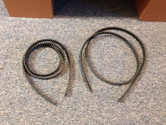

Two belts in two days

Belt twisted twice

Twisting occurs when the belt tension is low or slack.
The new U.S. distributor had me send the bike to them. They determined the bike was improperly assembled, and replaced all of the hardware for the rear wheel assembly. They also adjusted the bottom bracket after discovering the front pulley was moving in an odd manner.
I had noticed a sensation of rear wheel wobble when riding downhill, but could not see any play upon inspection. Turned out I wasn’t imagining things as the wheel had 3mm of play in it. I suspect the looseness allowed the belt to creep off the sprocket when under load.

Just a quick report: Bike has been riding better since getting it back, but today the belt became twisted again. The new US distributor seems to be at a loss. During previous belt twistings the disc rotor became warped. I wonder if there is a warped spot that is behaving like a deraler, and causing the belt to be slightly shifted over – resulting in these twisting events.
What did the US distributor to temporarily solve the issue? If he just changed the belt, then it will come back for sure.
I am convinced that your rear pulley gets misaligned (= not parallel to the front pulley) when you put effort on the pedals. The belt then climbs on the pulley flange and gets twisted.
As suggested in my previous post (see above), the preload of the rear joint has become too low, which causes this lateral movement of the rear wheel and consequently the belt twisting.
Several solutions exist: BlackStridaAustria will help you to choose the best one.

I don’t think so: There are a few mm’s between belt and and disc; usually you would feel a disc dent of a half mm while breaking.
If the disc would be that much bent to reach near the belt - then would your rear brake not be functional.
You wrote above “they replaced all the hardware” - do you have verified info what exactly they did?
