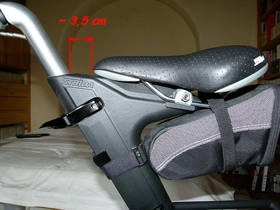

Took it for another ride yesterday, and well, the seat will be changed quicker then I expected. I’m not that tall, 1m76, but the stock seat is to far forward to my liking.
Aha…out of curiosity; what kind of tools did you use to get the wire through the frame tube?
Did you also notice that the Holes for brake cables have sharp edges?
Hard to tell from your picture, but did you already try to loosen the saddle bolt and push the saddle more backwards?
I’ve moved the seat back another 0.5cm, and now it’s at it’s furthest so we’ll see… (it was only at about 3cm back)
