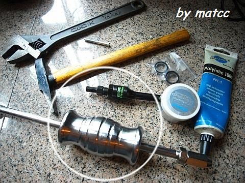

The changing of these bearings is not really difficult, but special tools are needed
(at least a slide hammer and a bearing extractor, mentioned already here and there.)

Indeed yes, a bearing change should not be a challenge for an experienced bike mechanic - preconditioned the mechanic has correct tools; a bearing extractor (bearing puller) with slide hammer for size 14-19 mm will be needed.
May I suggest that you simply call a bike workshop near you and ask if they are able to retract and reinsert 6802Z/6803Z bearings into an aluminium frame.
