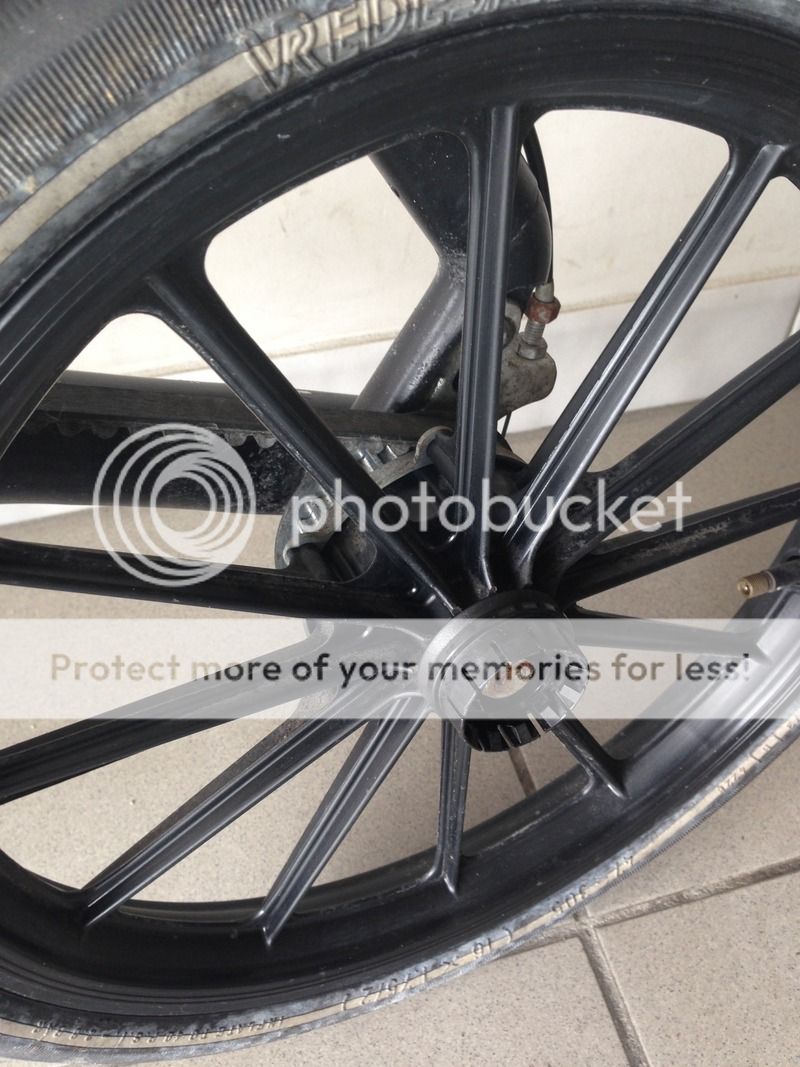

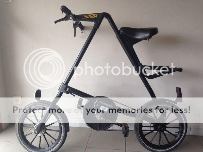

So, i got my hands on an old Strida. I t must be the first generation, because it has a straight steering and no foldable handlebars. It also doesn’t has the foldable pedals. :confused:
The missing foldable handlebars and foldable pedals, are not that important to me, so i will leave the Strida original.
Question 1: is this the very first type? It has a number that says 6620
The bike is in a poor state, but then again, everyting os working properly. No rattles, no suspicious noises, no abnormal play …

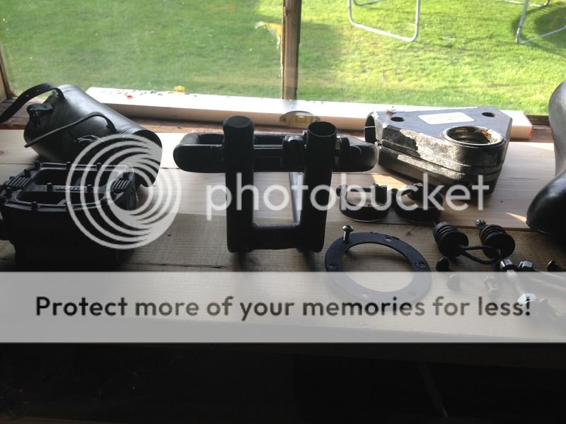

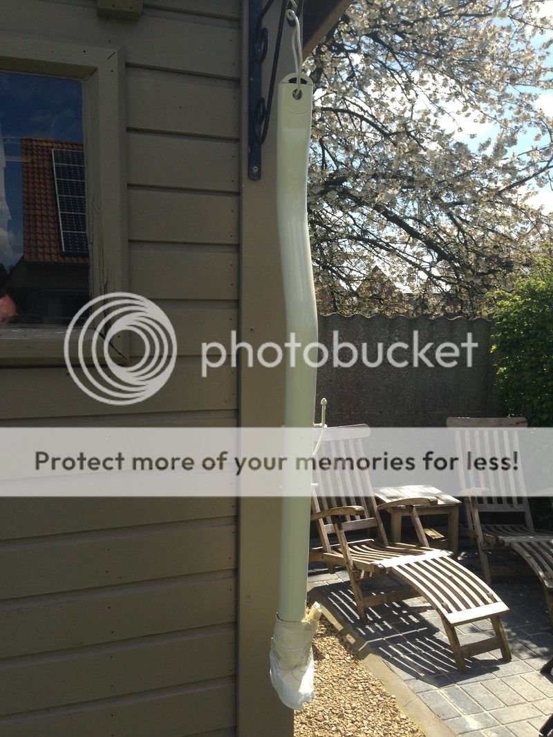

In around 3 houres, the bike is completely stripped.

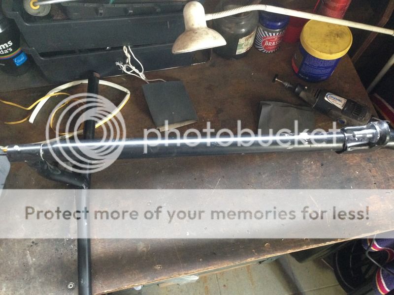

The next few days, it will be sanding off the whole frame, then give it a prime, and then a glossy spray.

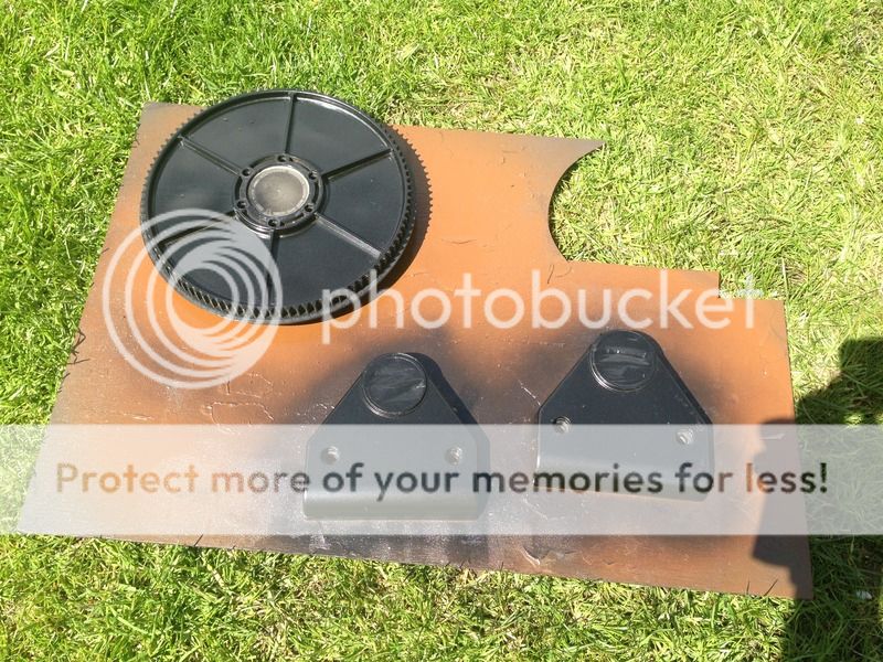

I removed and sanded away all the rust here and there and also he alluminium bracket plates because some corrosion began to show.

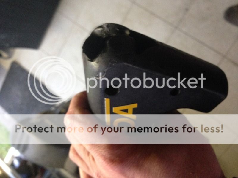

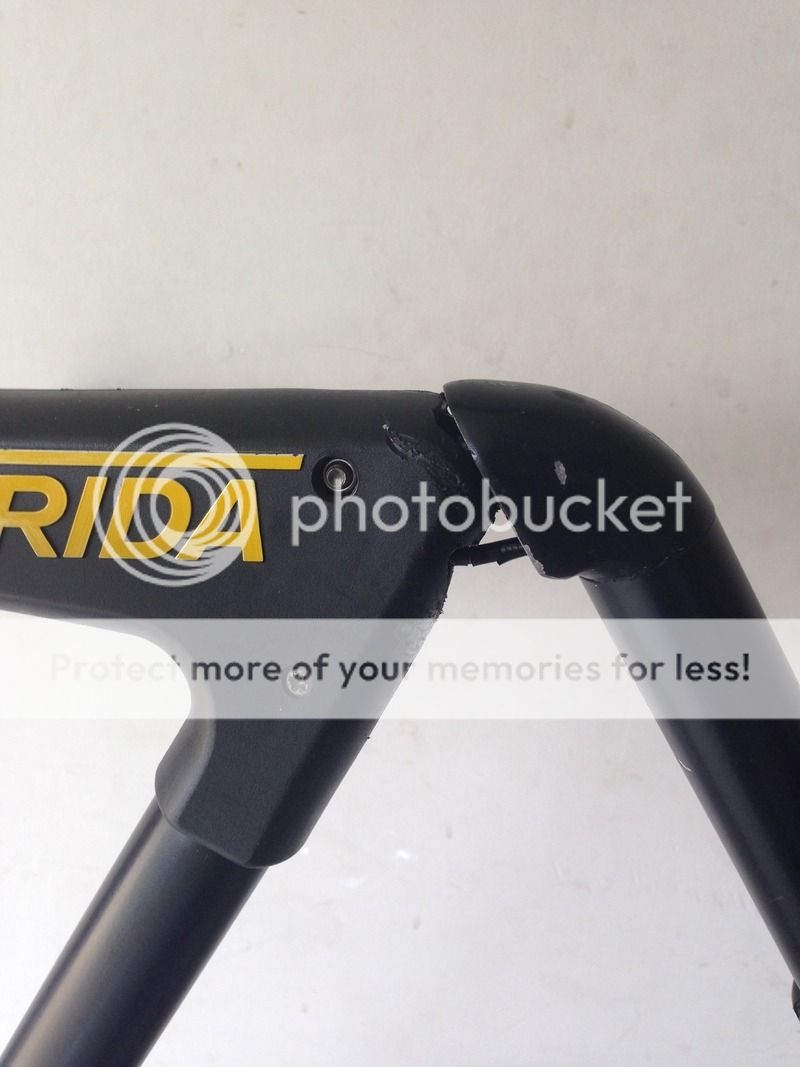

When spripping the bike, the steering bracket seems worn out. I just don’t like the look of it inside. But then again, the pivot shows no play and it still feels like it’s in a good solid lock between the two steerings halfs. But i will replace it anyway.
Question 2: can someone tell me where i can order or buy the original steerings halfs? Like shown in the picture?
Question 3: i forgot to measure up the distance between the steering and the locking mechanism above the front wheel. Can someone measure this up for me? I would be greatful … :unamused:

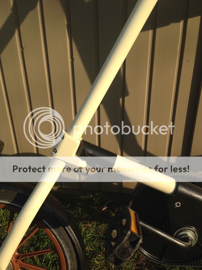

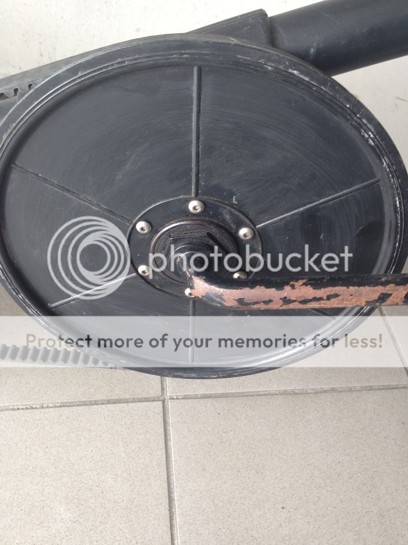

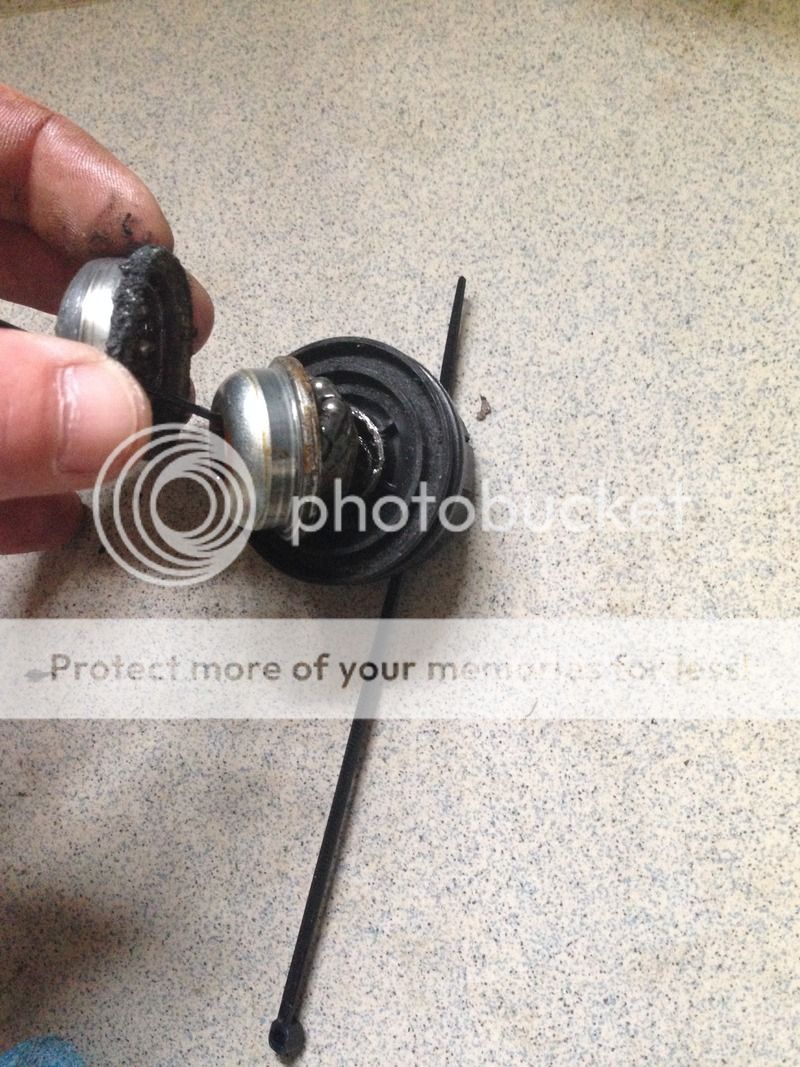

Question 4: i can’t get the plastick thing out the horizontal frame bar where it connects into the locking mechanism. Is it removable or not? I got the screws out, but no movement at all … and i hate banging with a hammer … it would be nice if i could get it out, because it is easier to spray when everyting is removed …

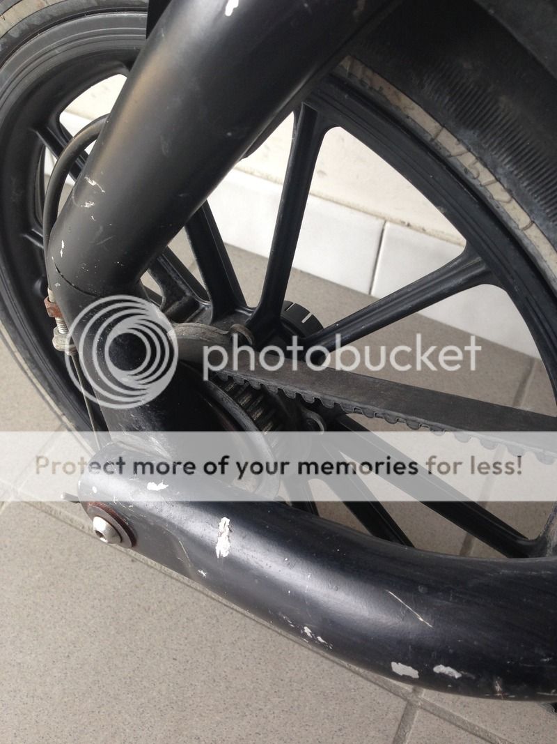

Question 5: i think i miss a part. When folding, there is a piece missing. I think it is some kind of clip that holds the frame bars together … or could it be i am missing something logical? :unamused:

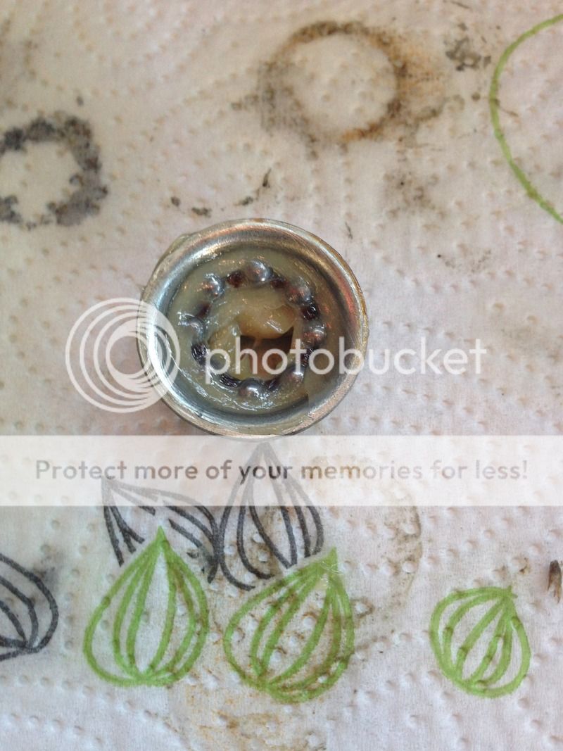

The shafts and bearings definitely need some fresh grease, as the old grease is hardened out and no good anymore.

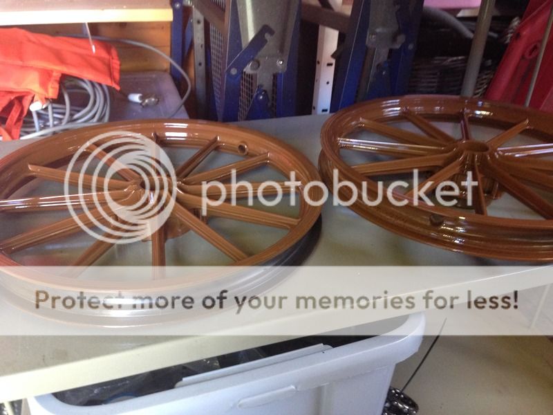

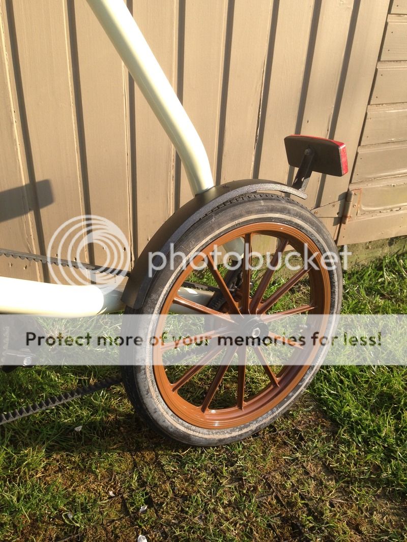

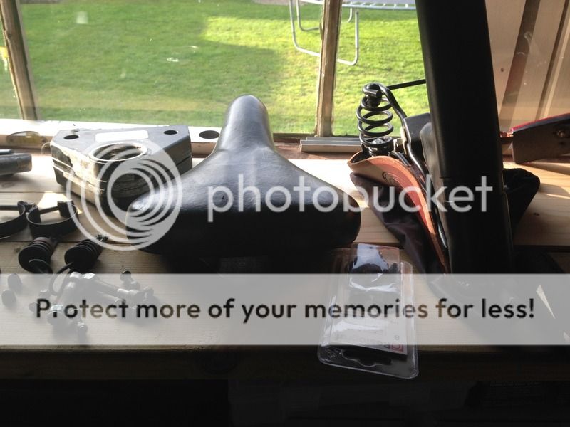

I will go for the Brooks saddle and i’m also thinking of leather grips. And i will spray the wheels in chocolat brown … and the frame in ‘Libian Sand’ … love that colour!

I have sent an email to ‘VanMoof’ and ‘Velorution’ and i hope they can help me out with the top ball joint. If not, then i am thinking of a modification like someone else on this forum did …

Wheels chocolate brown.
Brooks sadle.
Leather wrapped steering wheel.
And the upper ball joint will be upgraded to the newer model.
Parts on the way. :wink:
Good idea to choose a recent model, too :smiley:
I’m curious how to do that, looking forward…
Well … i was planning to keep the MK1 Original, but that won’t be possible due to no more parts available. :frowning:
So i am going to order the plastic upper ball cup from a recent Strida, cut the steering tubing, fiddle the ball cup in and … i think this will work.

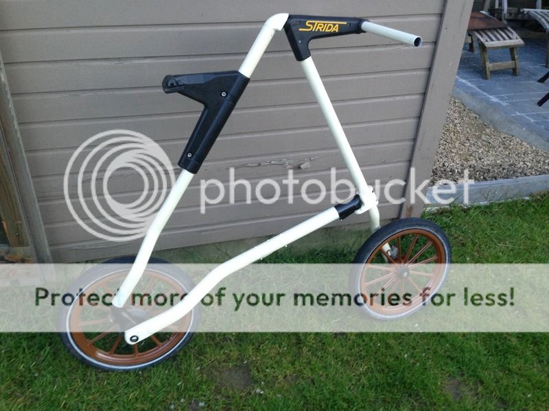

Almost …
Washed out the bearings. New grease. Love the looks.
Hej - why didn’t you tell us earlier that you’re a professional conservator? :smiley:
Very well done - respect!

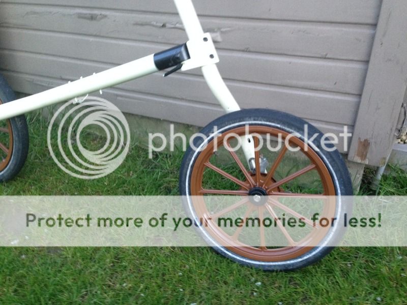

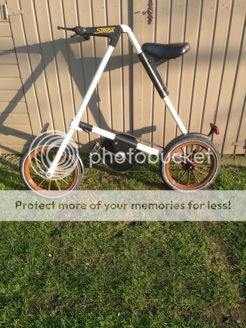

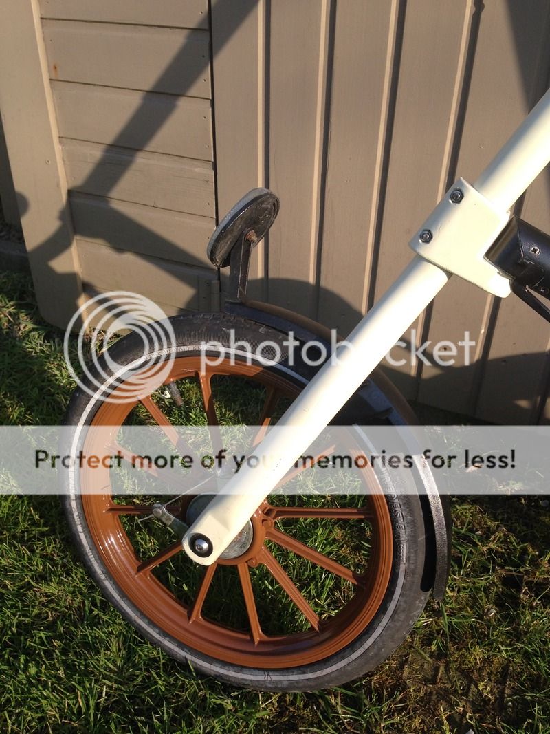

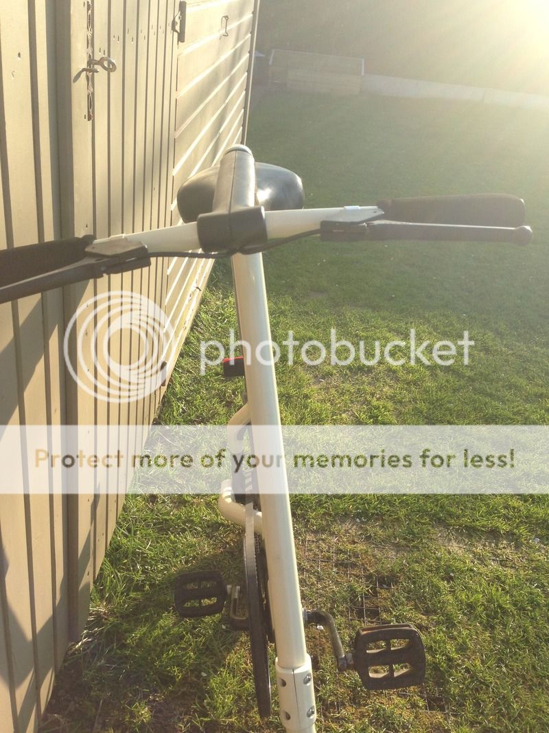

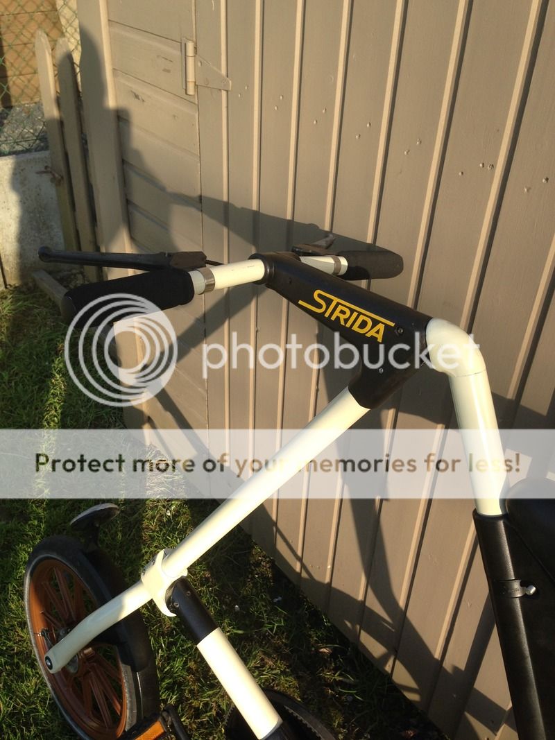

Finished.
Wow, it looks great. Enjoy your new, [old] Strida.
Bill
That’s right!
At first sight I’d never suspect an ancient MK1 behind this whte beauty :laughing:
Hi guzzio,
remarkable paint job.
About the ball joint holder, I wound’t ride on it: it’s a safety critical part and your joint holder looks in bad shape, tough not as bad as mine.
