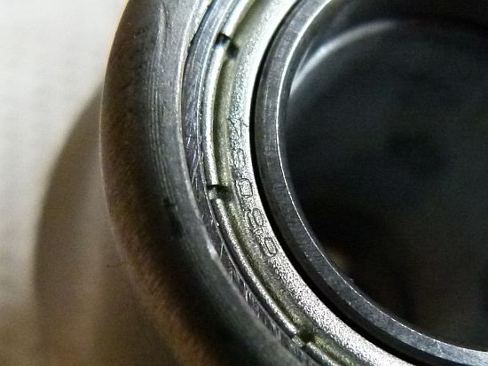

Especially the “3” is hard to verify at the pic, but the dimensions are also matching 6803 - outer Ø 26 mm, inner Ø 17 mm.

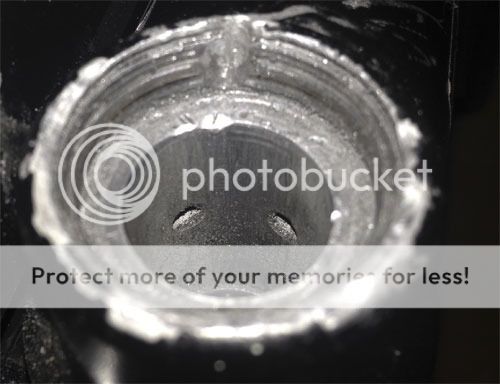

Here:
Title is: a desperate man and his dremel…
Hi Marco,
something is wrong with your picture link…
I know, I’m working on it :mrgreen:
Using photobucket instead of google photos made it…
:laughing:
OK, looks like you did not get the ring out :question:
Like I said, this doesn’t look like a ring you can get out. It looks like it’s part of the frame. :confused:

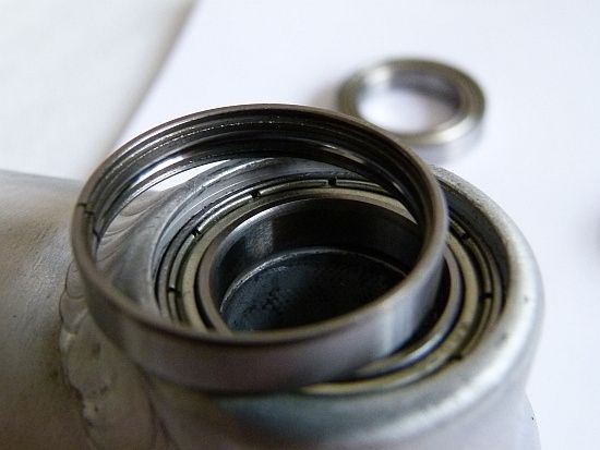

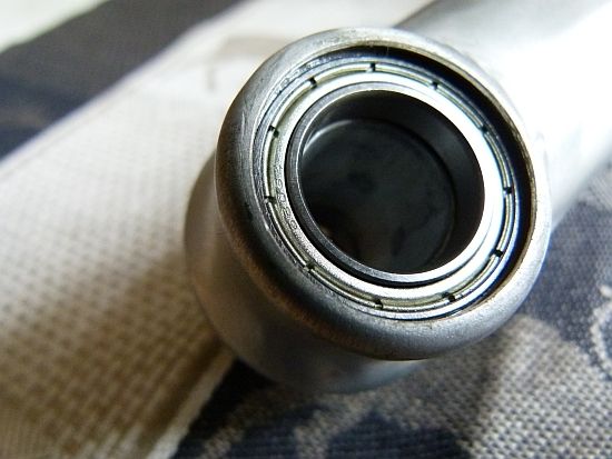

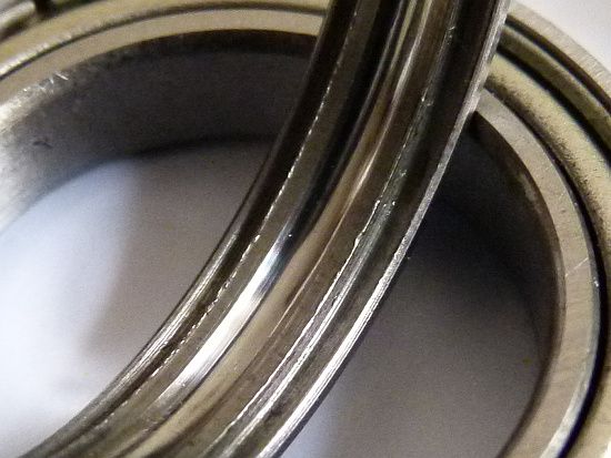

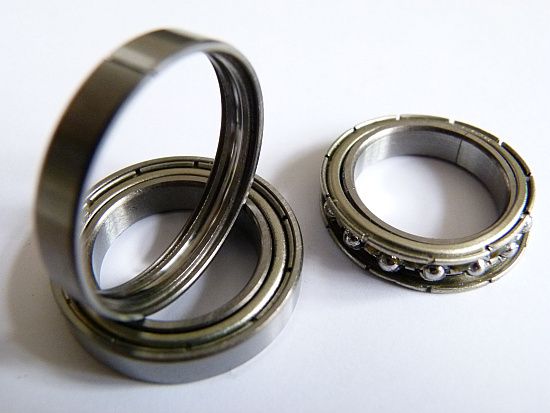

Today I’ve cracked a bearing for us to have a look inside;
there are three grooves clearly visible in the outer bearing ring,
the big in the middle for the balls and the others for the two bearing covers.
Outer bearing ring laying on bottom tube:

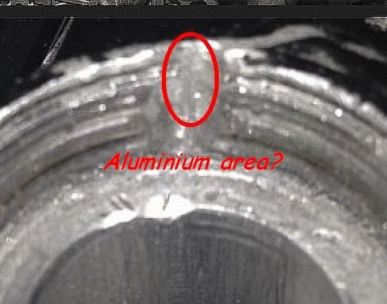

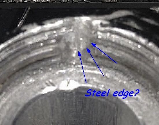

Could it be that you’re almost cut through the steel ring,
and there is already a small area of the Aluminium appearing?
You could check that easily; just try to sting into this area with something spiky -
if you are able to create a tiny hole it’s for sure Aluminium,
most likely you can’t even scratch the very hard bearing ring!
The inside of the outer ring looks very much like what i see in my bike… I’ve already tried to pry the thing apart from the frame, I’ll try harder and let you know. Thanks again!
