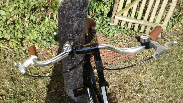

Chris built in for me :
The Strida touring handlebar with brown leather handles and copper ending disks. This wide handlebar makes riding the Strida much more safe. No wobbly feeling anymore.

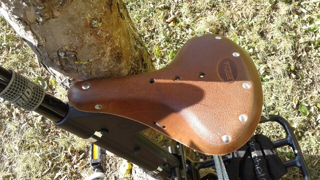

Strida’s spring-loaded brown leather saddle. It’s an one hundred percent improvement. Before with the standard saddle crossing sidewalk borderstones or riding on cobble stones caused migraines because of the severe vibrations and shocks. Now it’s a much smoother ride.
