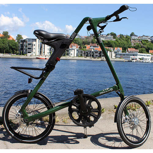

Updating this old thread, after a search on the forum: This exact same thing has happened to me now, unfortunately. Except that it happens much more often than 3 times during a ride. This morning the 1st gear became basically unusable - it slips constantly, especially during climbs. In the two higher gears it doesn’t seem to happen.
Is the the only solution is to exchange for an all new gearbox? I bought my bike secondhand, but I can check if it is still under warranty.

Thanks, that’s a bummer.
This does not apply in Norway. We have very strong consumer protection laws here, and items like this which are supposed to last a long time are under warranty from the Norwegian seller for 5 years, also for secondhand buyers. So the warranty in my case is not from Strida/Ming cycle, but from the Norwegian seller, who will then have to cover the expense. Fingers crossed that they accept it without any hassle!

It’s not a very active seller, it must be said… It’s a shop which sells thingies and accesoires for boats and life on boats. But they do not seem to stock any stridas at the moment, and don’t sell any other bikes. So they probably don’t have any in-house bike mechanics who will know how to replace the gearbox. But given that the bike was originally bought in 2020, they are legally obligated to fix it for me. Now I just need to procure the sales receipt from the guy who sold me the bike…
