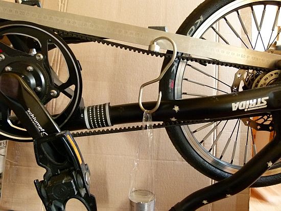

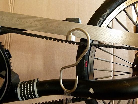

Well…at the pictures below was an Aluminium rod hung on the belt - the weight of this assembly is ~ 500 grams.
(I had to use the downside part of the belt due to the smaller diameter of the speed drive’s 80 teeth belt wheel. The upside part would touch anyway the frame during such measurings.)
As you can see is the gap between the ruler and the belt much higher than 2-5 mm; actually are this about 12 mm.
Would I use my arm it would be much more.
I mean 2-5 mm “play” are a sign of too high belt tension, most likely is that possible with the plastic wheel (because it’s flexible), but not with the alloy one.
Your belt tension was too high in the past I believe, please try to decrease it.

WOW! :laughing: BSA you rock!, thats what exactly I was looking for, and of course will be of much help to other strida riders, I´ll adjust the tensión according to it.

I can be wrong, but what Mark says, is that the distance between the belt and the bottom tube becomes 2…5 mm when loaded with the arm. So without the arm on it, this distance is maybe 10 or 15 mm.
What you measure in your example is the deflection of the belt, which is not the same.
Anyway, Mark’s method is not good as the distance of 2…5mm depends on the diameter of the chainwheel: on a SD, the chainwheel is smaller because it has a lower number of teeth (80t), so the distance between the belt and the bottom tube is anyway smaller than with the standard 100t chainwheel.
What I’ve always done is to keep the tension at a very minimum, because the snubber is there anyway to prevent the belt to “pop”.
Hi Bietrume,
you’re surely not wrong, thank you so much!
I wondered from the beginning about Mark’s formulation, but honestly; I didn’t understand it :blush:
Now I know what Mark meant - in fact he recommends a deflection of about 10 mm.
(Say 15 mm distance from belt to frame unloaded minus the loaded distance of 5 mm.)
My dear friend, I wouldn’t know what to do without you…
