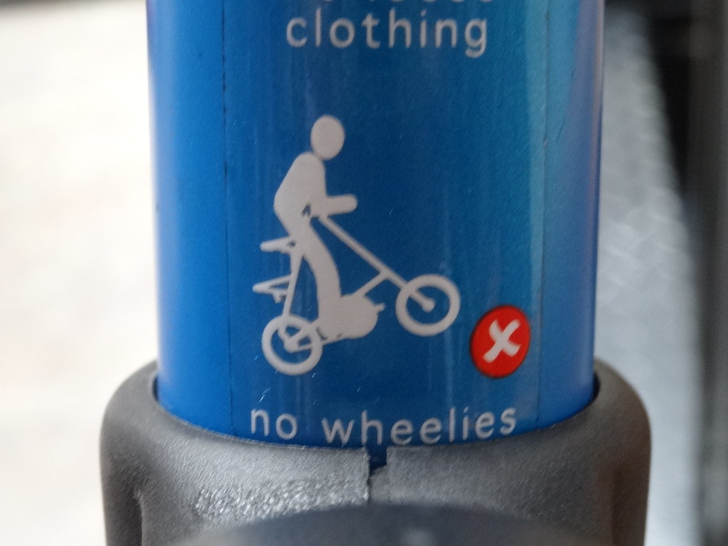

Hi, my brother has his eye on a strida (Sydney, Australia) and a friend said there is a warning sign/sticker on Strida bikes, saying “wear a helmet. No wheelies. No loose clothing” that is missing from most fakes and may be used to check whether the bike is genuine. Is this valid? Where is this sign? Is it on all models, is the 5 too? Thanks for advice k

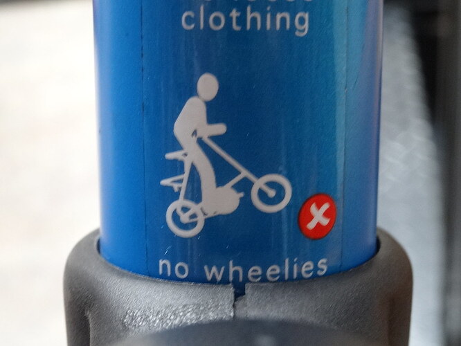

There is actually such a sticker at each Strida, it is usually attached at the seat tube, close to the upper ball joint.
