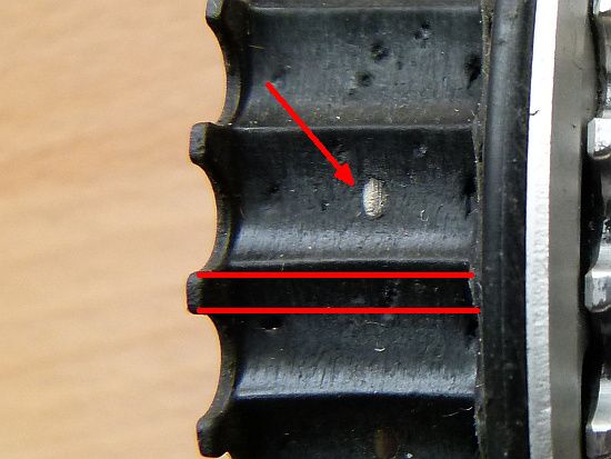

- As mentioned; this plastic freewheel is the worst we’ve ever seen
![:open_mouth: :open_mouth:](https://www.stridaforum.com/images/emoji/twitter/open_mouth.png?v=12)
It appeared at Mike’s local bikestore http://www.dasfaltrad.at/ a while ago,
actually we’re wondering how this customer could ride the last two or three thousand kilometres…
However, we can see that the two tooth edges are totally disappeared (red lines) and due to that decreased the outer diameter dramatically - the belt will jump and it’ll be impossible to tighten.
Even the outer metal (bearing?) ring is partially visible, there’s not that much plastic left over.

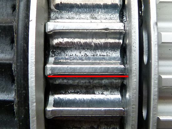

- At the Aluminium version moved one tooth edge a little bit.
That’s usually no problem, of course it may be required to tighten the belt.
