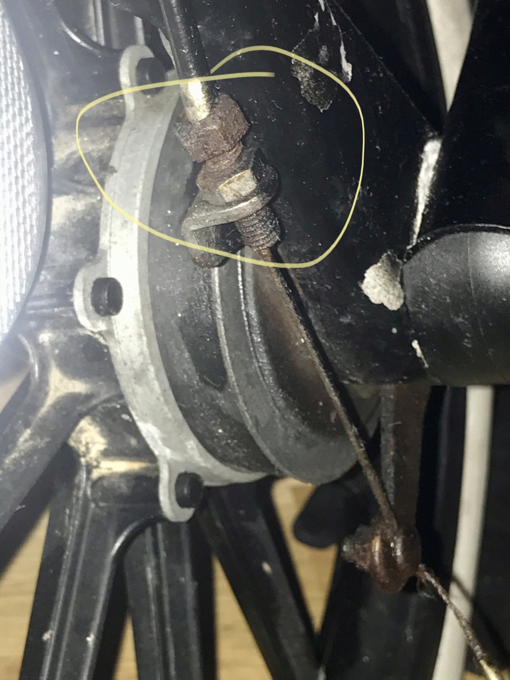

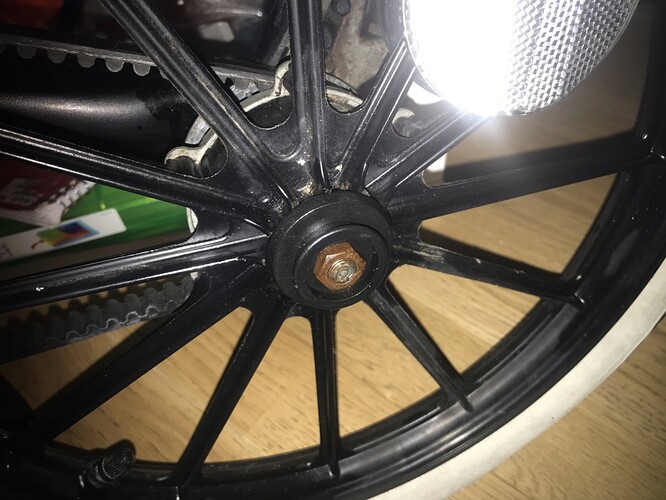

-the rear drum break seems stuck since the rear wheels turns with difficulty.
I am a bit worried about dismantling it to see what goes on inside…
Are the break pads available as spare?
-The hollowed out screw for the break cable is broken, is it standard?
-Are the break cable available new as spare parts at Strida shop?

No, I guess the preowner was creative :wink:
Or did you mean if you could use a standard cable adjusting screw to replace the shown, rusted one?
In that case I’d reply with yes, I think this is a standard part, too.
As far as I know there is nothing special at the cables, that is standard material which should be in stock at any workstore.

So for the breaks there is nothig to do? When the drum pads are dead, well , it’s dead?

I’d say that depends on where you are…
Look, if you would be in India, Pakistan, Vietnam or so - surely you could find somebody who could rivet new pads on your brake. They may contain asbestos, cause they are made from old truck brakes, but who cares there.
Just in France, as like anywhere in Europe/US - I guess a workstore owner would just laugh at you. :cry:
That is unfortunately the sad truth here, no one is interested in repairs, the less the smaller they are.
