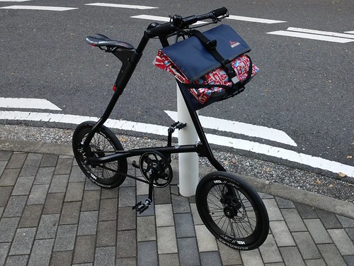

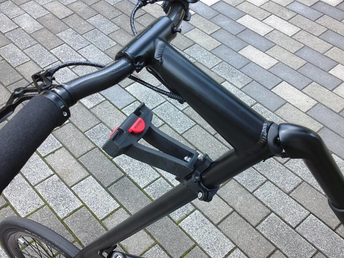

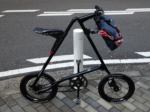

Luggage
monkii clip + rixen kaul vario rack KR810
more pics here: http://www.flickr.com/photos/genuine_strida/
Many thanks to Genuine_S!
Brilliant pictures - thank you.
