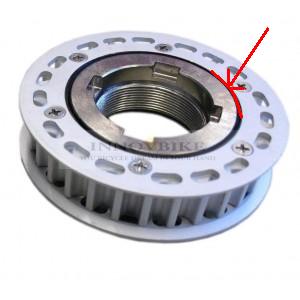

Could you please take a pic of your freewheel’s teeth?
Or, compared to below, how do the teeth look?
https://www.flickr.com/photos/131753955@N04/16151958534/

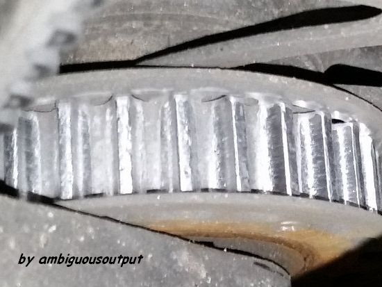

Okay I hope I did that right (posting a photo). I haven’t adjusted the belt tension (I don’t know how…). I don’t really know as much about this bike as I should but I can follow instructions with the best of them.
Thank you!
It’s most likely just too big, but no problem:
Doesn’t even look that bad…however you should find out first whether your belt is under correct tension.
