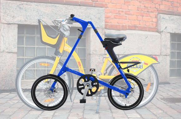

Folding bicycles never appealed to me before I discovered Strida while watching YouTube videos. The ingenious design hit me instantly and I started googling, where to get one. Being 166 cm high I also wondered how EVO would fit my body, how much compromized riding posture because of the fixed saddle height. There is no Strida dealer here in Finland so I was ready to take a shopping trip to Berlin and have a test ride. But my inquiries were not answered, not by the shop nor German distributor. I had to figure another way to check virtually. I went to nearby city bicycle station and seated on a parked bicycle adjusting first the saddle to optimal height, then took several measurements. EVO’s measurements I found online and with PhotoShop I sandwiched EVO and city bicycle scaled to match and with PS measure tool I could convert millimeters to pixels. I edited the saddle to position optimal for me. On the composite photo I could see that EVO fits me quite well, saddle to pedal distance being the same EVO’s saddle is lower to ground (couple of cms), thus easier to get seated. But there is more to riding posture, will experience it soon…

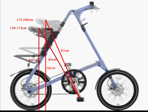

Thanks for welcoming me and your comments. I’d like to add some more info how I have been done some research based on online photos. Well, I should have been more circumstantial in my writing: when I wrote one fixed saddle position I was thinking the lower mounting for us short people (me 166cm).
Before that comparison with local city bicycle I did similar with two product photos with exact pixel size, angling of crank arms, only one had different saddle position. Based on known wheelbase I could do pixel measurements giving following result:
But this was not enough for me so I had to have a “bottom-on” comparison and thus seated on a city bicycle with my tape measure. Funny, the field measurement saddle-pedal happened to be the same 82 cm as on my sandwich comparison above. Am I the ideal small size rider of Strida? I will report it later after arrival of my EVO… (right now in hands of DPD)

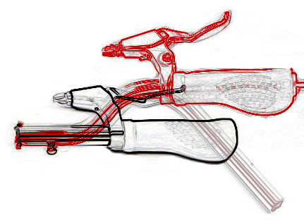

You wrote welcoming words how I could test Strida in Vienna. I’d love to visit you if only I could afford it at the moment. Thinking back my MTB years with different stems and handlebars I was curious to know how much difference those different alternative Strida handlebars would give. Based on rather poor product photos I scaled them by the mounting pins to get following composite image. If only somebody would do this properly… (dreaming)…
I am used to steer my kick scooter with it’s 40cm wide handlebar and am curious to experience the feel of steering EVO. Thinking of the weight distribution I could consider that handlebar meant for large riders.
