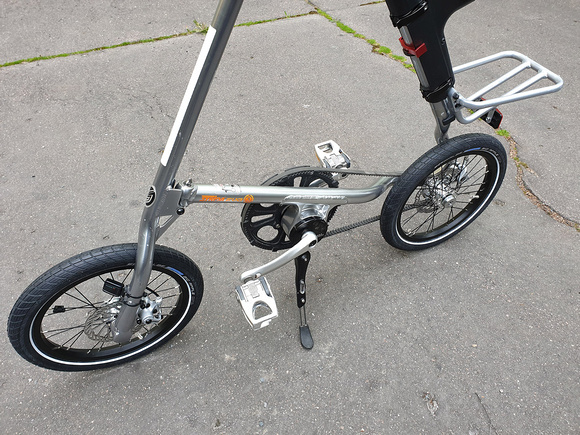

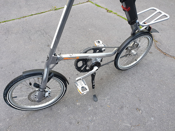

So you are interested in 18" wheels? Chris emailed me because he helped me when I wanted smaller 16" wheels on my Strida. I already sent you private message but wanted to tell you also here that I could sell complete set wheels including Innova tires, tubes and fenders, all in good condition. I look forward to hear from you.
Original 18" wheels:
Updated 16" wheels:
