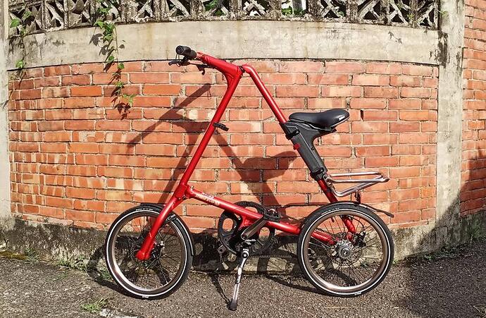

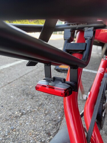

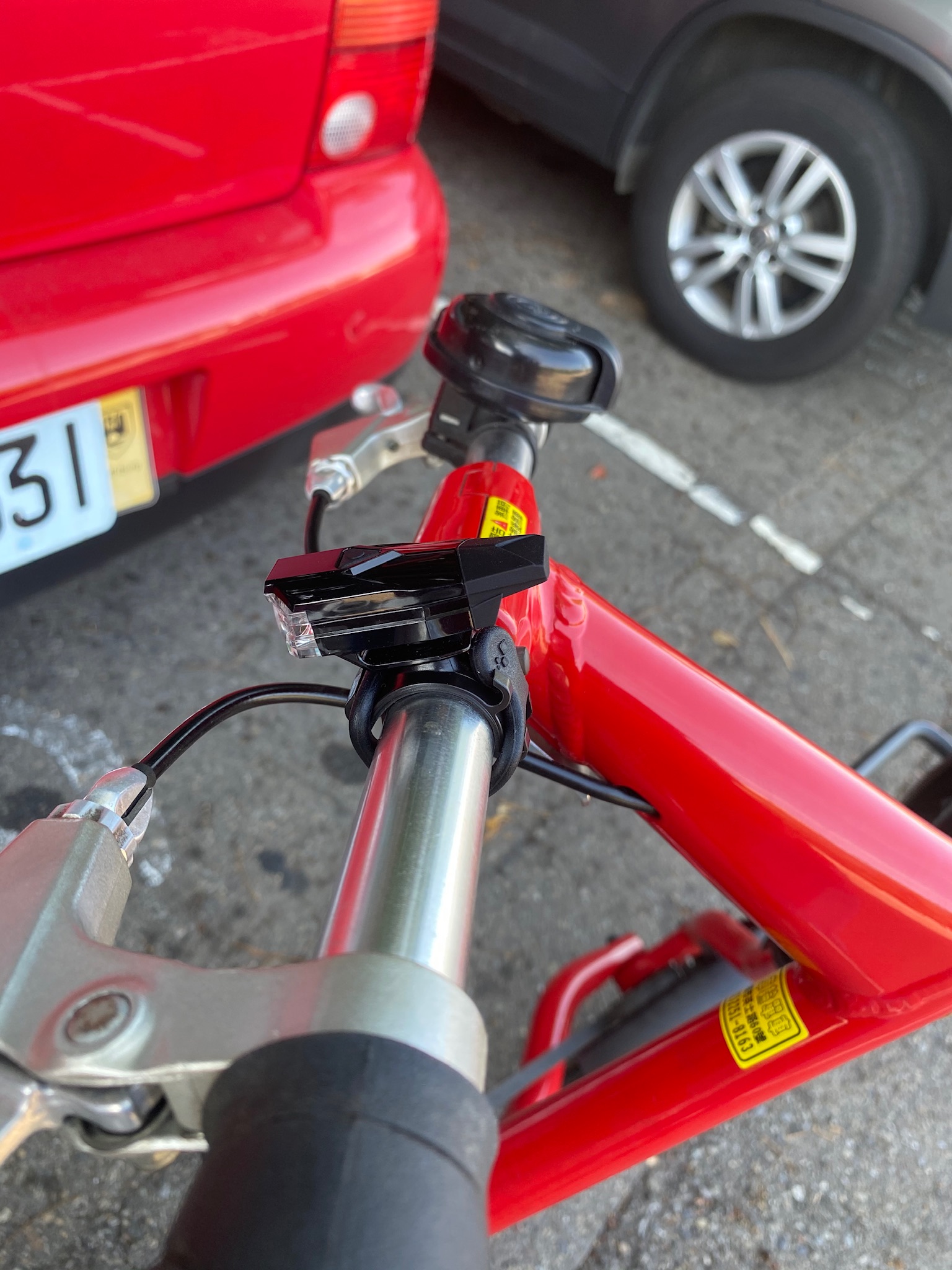

Here are two photos of my 4.1 . I replaced front and rear lights .

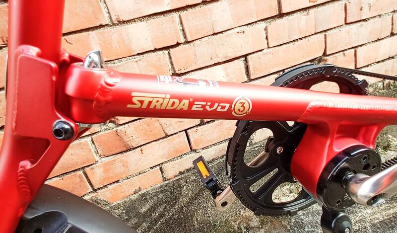

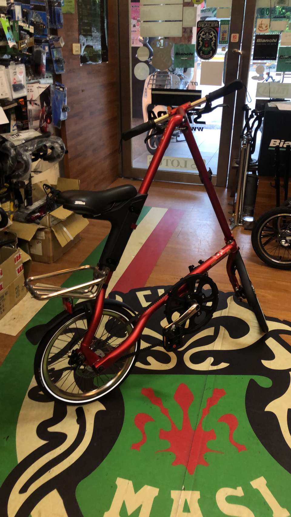

SX 2020 new bike. I can choose color and configuration. if I pick the Standard one , they offer me no discount on list price($700) but they can give me $70 (or maybe even $80) accessories free in the deal.
I asked the dealer guy which one he would pick if he was me ? The answer was simple, he would pick EVO because of its 3-speed and best price. So I made up my mind . I bought EVO3
