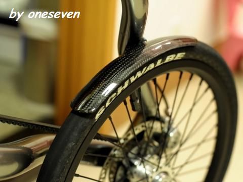

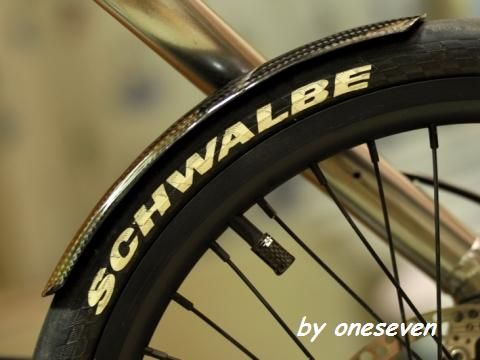

But of course I’ve spent a lot of time thinking about it - and I mean a complete recreation of fenders is actually not a simple task.
Oneseven, a member of Hong Kong Strida club, managed years ago (somehow ??) to manufacture his own - Carbon! - fenders,
unfortunately there’s no info about the constructon of the frame connector part.
Exactly this is a crucial point I believe:
The connection from fender to frame should be anyway adjustable!
And why not make the inner edge of the mudguard out of some soft plastic (or silicone)?
Even if the guards would touch each other in folded position it wouldn’t matter…
