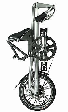

about the folding thing I saw sometimes people folding the rack this way
Not sure that I’ll need but just to understand if mine is correctly assembled. My rack cant stand like this and will fall down

About the rack indeed I tried to tight the bolt but doesnt go more than that.
It goes down in the correct position, if I press it attach to the frame correctly but does not stay up like in the picture. Just this. I’ll ask the vendor as I have no idea on why this happens.

That sounds as you would expect some kind of function which is not really planned.
However - looking at the mechanical function of the carrier connection (to the seat mount) it seems that you can not simply tighten the bolt 370 harder to get some friction (and your desired effect) into that joint!
For my meaning (knowing that “Ming cycle” and “precision” will never meet) I’d assume that the two latches for bolt and nut are a little bit too far away from each other.
When you move the rack over the plastic seat mount (without bolt) - does it have much play there?
Hi again
you mean that the rack should not stay like in the picture below? Mine does not and yes there is some play that obviously does not allow friction. But I still do not get if that is normal or the rack should be able to close like in this picture

I’ve checked on two of my bikes with identical seat moldings and the same, black carriers:
  • On my silver EVO the carrier stays in the position shown above, the distance of the two latches to each other will be ~ 30,6 mm.
  • At my blue efneo the carrier falls down immediately, the latche’s distance is here ~ 31,4 mm.
    …and there is one thing obvious - I can see the bolt in the gap between latch and seat molding!
Try to fiddle a washer between one latch and the seat molding and it will work just as you want.
Please do note that the word “tolerance” does not exist in Ming cycle’s vocabulary :unamused:
