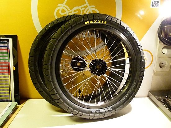

Unlimited tyre width can be achieved only by changing the rims to wider ones - that means custom wheels, examples below.

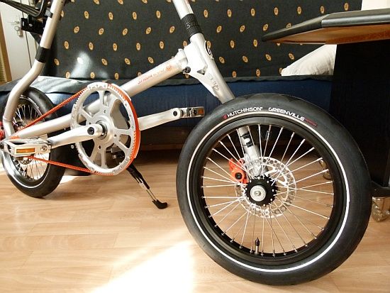

By the way, what do you think about the hutchinson greenville? They look pretty cool on the bike!
For my meaning is the Hutchinson Greenville pretty similar to the Schwalbe Big Apple Balloon; much cushion and stability - in rain it may be problematic.
Logically at that width it is required to modify the magnet lock mechanism, there are several ways to do that.
Big withdrawal of the Greenville - most likely it does NOT fit on original Strida wheels.
That above are very wide, riveted BMX rims.
