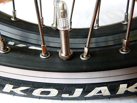

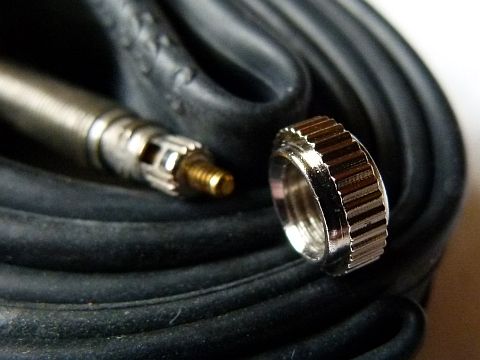

Hi cubicapple,
no problem, the correct Schwalbe tube identification is “SV 4” btw.
The Schwalbe Presta (or Sclaverand) tubes are equipped with a valve stem nut which has a stepped shoulder to fit the (bigger) valve stem hole of the original Schrader rims.
For example Genuine_S is using this valve, also myself on the 3 cross wheels.
If you choose a Schrader - Presta adapter like these:
it should be possible that you use your existing pump, I mean?
