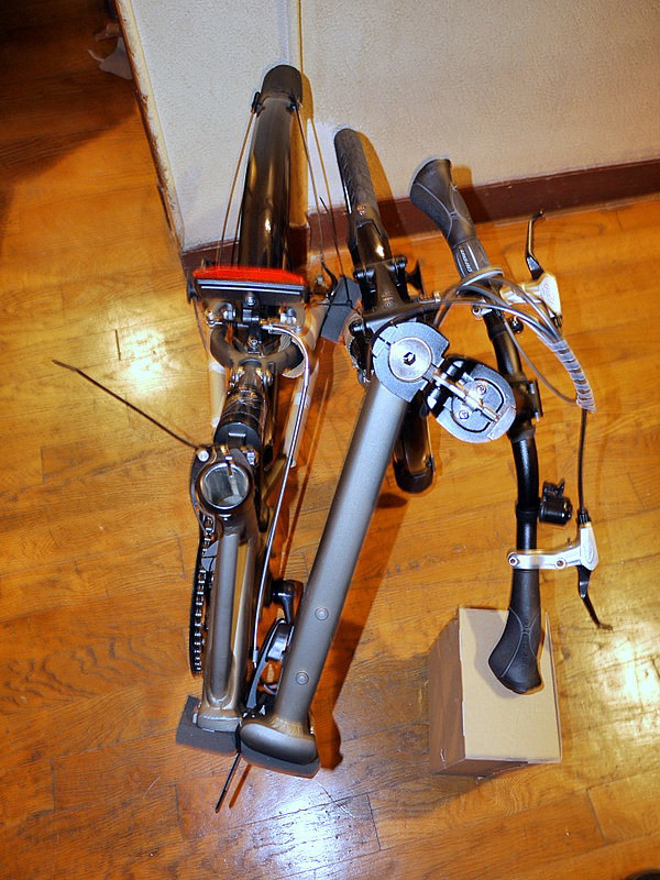

Hello Striders,
I ride my EVO3 everyday to go to work.
And I fold it 4 times a day.
It seems it is too often and the rear brake hoose is progressively damaged until it is pretty cut :imp:
It is the second time I’m facing this issue.
The first time the dealer replaced the hose under warranty with the red one you can see on the picture. 6 monthes later, it is cut, but the brake is still working.
But I think it is dangerous to continue riding the strida with such a cut hose.
Did some of you already face this problem ?
I’m contemplating replacing it with a stronger hose, maybe a mountain bike hose such as jagwire.
Any suggestions?
Is it easy to replace it by ourselves?
Thanks :wink:
Here is the photo.
I forgot to log in on the first post :blush:
I think some moderators have the power to turn guest into logged in people :smiling_imp:

Hello striders,
I replaced my rear hose on yesterday evening.
I was quite surprised because it was easier than I initialy thought.
Here is the kit I bought : decathlon.fr/kit-cables-gain … 89252.html
I read the different topics you mentionned above, and did a mix :
  • removed the cable
  • removed the rear part of the cut hose
  • introduced the new hose from the bottom of the tube, up to the top of the triangle.
    => Here was the main difficulty : I I had to use tweezers to grap the hose and get it out of the tube, then pushed it from the bottom.
  • introduced the old cable into the front part of the cut hose, in order to use the cable as a guide for the new hose
  • removed the front part of the cut hose, but not the cable
  • removed the spring
  • introduced the spring on the new hose, and insert the hose on the cable
  • pushed the hose so that it crossed the handlebar stem and guided it outside using the cable
  • removed the cable and cut the hose on each end + add hose end parts
  • introduced the new cable
  • done
