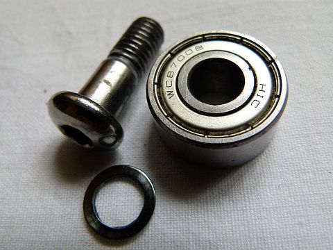

Anyway, it did not help - it seems that there is not enough difference between bearing inner diameter and bolt outer diameter. I’ll measure them all and post here.
Agree, bearing has i. d. 8,0 mm, the bolt o. d. 7,85 mm (unthreaded shaft) :unamused:
For comparison:
bolt M 8 x 25 mm flat head , 15 mm threaded
head height ~ 4,3 mm
head o. d. ~ 13,8 mm
Allen key 5 mm
Bearing WC87008
o. d. 22 mm
i.d. 8 mm
height 10 mm
washer
o. d. 12 mm
i. d. 8,3 mm
thickness 1 mm

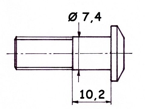

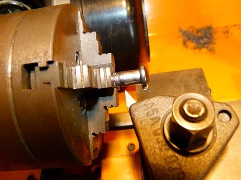

A simple modification, done by a turning lathe’s user (car/bike garage, mechanical workshop, turnery) should enable the desired function of the snubber bolt.
Reducing the shafts diameter to 7,4 mm would generate a gap of 0,6 mm instead of 0,15 mm.
(0,3 mm onward and 0,3 mm toward the belt :exclamation: )
Would that be sufficient :question:
