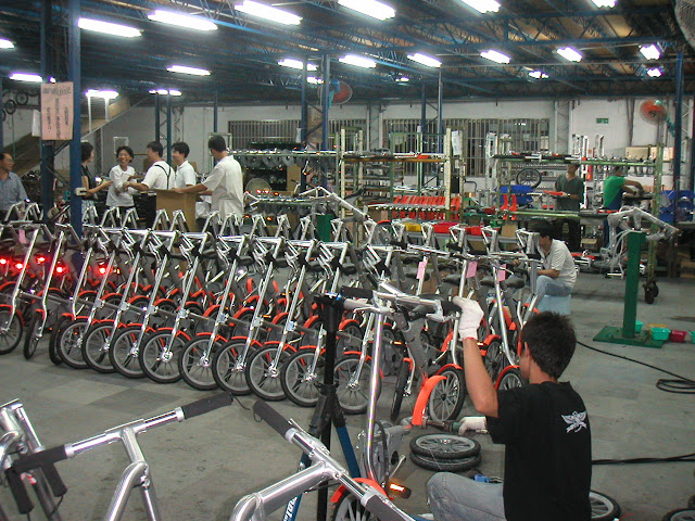

Maybe you’ve bought the early version of Strida 3 which still uses plastic clip rings to stick the wheels together when folded.
Early version of Strida 3 in Japan
Photo of early Strida 3 production at Ming Cycle from Mark’s web alumb
picasaweb.google.co.uk/MAS.DPL/S … 5754217730
