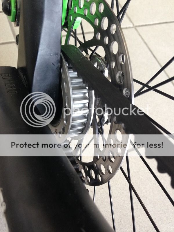

Hey Blackstridaaustria

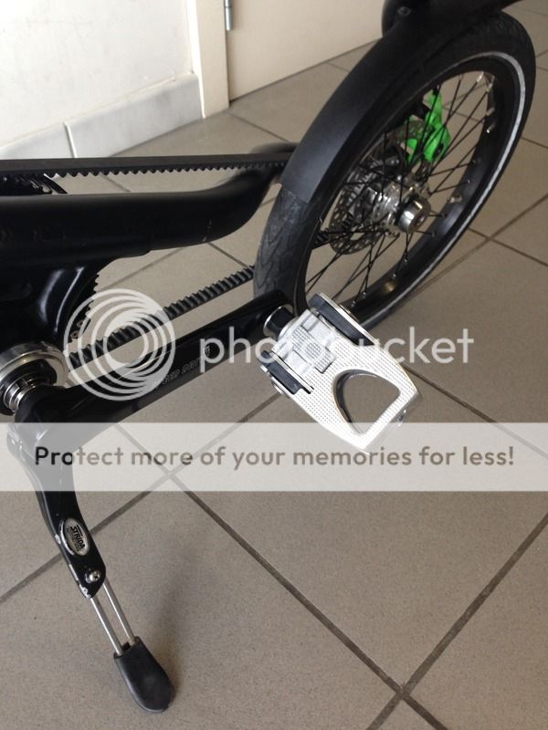

It’s the bearing on the last picture. As i stop pedaling, i hear the rear bearing grinding. I am sure it’s worn.
Do you now if it’s possible to open up the bearing to have a look inside? Or is it a closed unit and not greasable …

Hi guzzio,
guess you mean the freewheel, part nr.: 340-05…
It is - but it doesn’t make sense.
Open the freewheel
Simply replace it - special tool “T” needed.

When i put the belt of an turn the crancks, no noise at all from the Schlumpf drive. So i am certain now that the noise comes from the freewheel at the rear wheel.
To be continued.

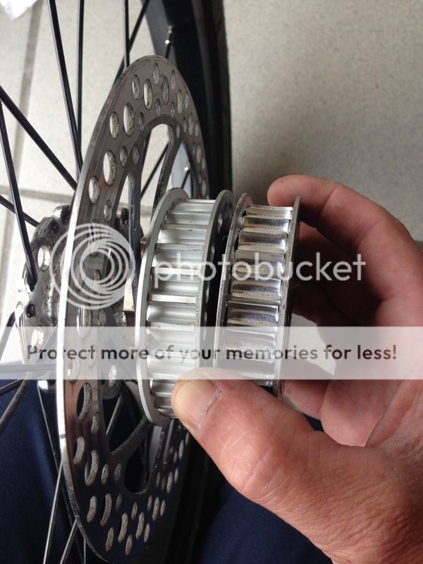

Hi, The noise at the rear wheel may be coming from the small snubber bearing, something else to check. I have both the snubber bearing and the freewheel in stock.
Bill

So … had the time to replace the freewheel bearing. It was worn out and noisy. Replacement was a 30 min. job and easy.
Also replaced the folding pedals.
NOTE: the preload on the bearing from the folding pedals, were way to stiff. The pedals did not spin around smoothly from out of the box. So i losened up the nuts a ltittle bit and did some extra grease on the bearings. So to Strida: don’t be so niggardly with grease and check that preload when selling rather expensive folding pedals. :frowning:
But everything just worked out perfectly. No more noise, very smooth. Very happy!
And by the way. I also removed that roller bearing under the belt, just under the freewheel bearing. It just causes extra friction and i don’t see any reason why i should leave it in situation. :confused:

First - many thanks for teaching me new words!
Ah!?
Well…you don’t see any reason yet…Ok…
BUT, once your freewheel started wearing a bit, with decreasing belt tension and much force at the pedals - like going uphill or perhaps even doing wheelies
  • you may miss it…
