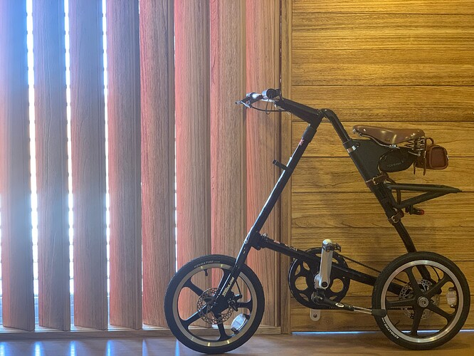

Mini upgraded to 16” plastic rim
16x1.25 tire
Front wheel clearance = around 3mm (almost no clearance)
Rear wheel clearance = around 8~9mm
  1. It is said that 16” plastic rim is a little heavier than normal metal spoke rim
  2. Also, with well adjustment, metal spoke rim has less deformation than plastic rim. And the driving force delivery is more efficient.
  3. However, plastic rim need no maintenance and it won’t have metal spoke broken issue.
