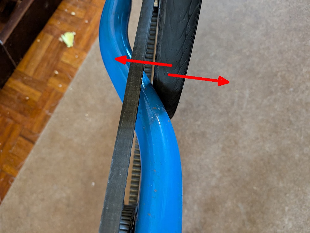

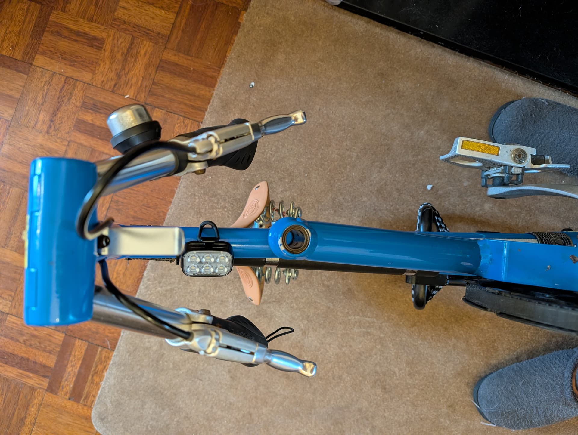

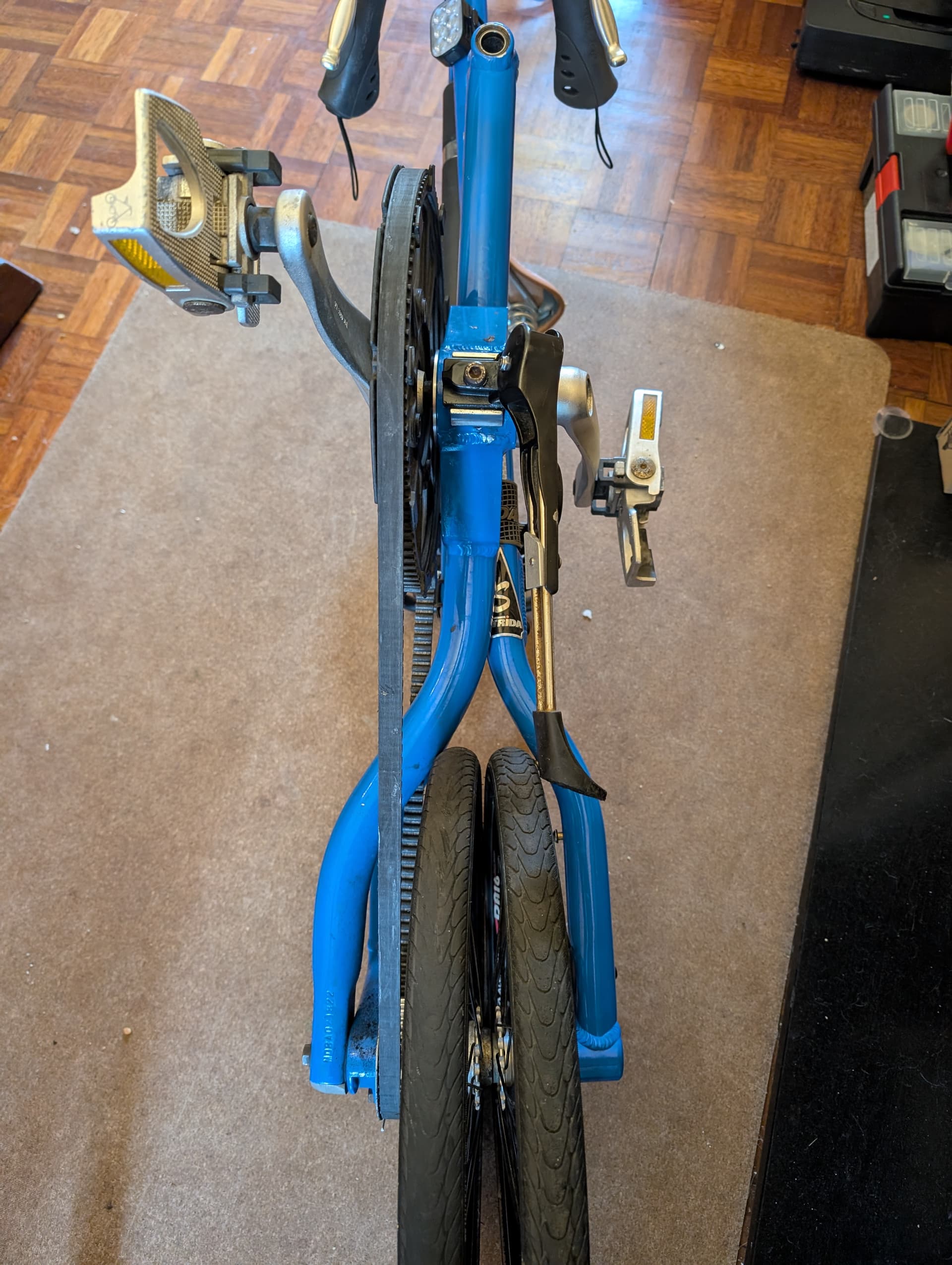

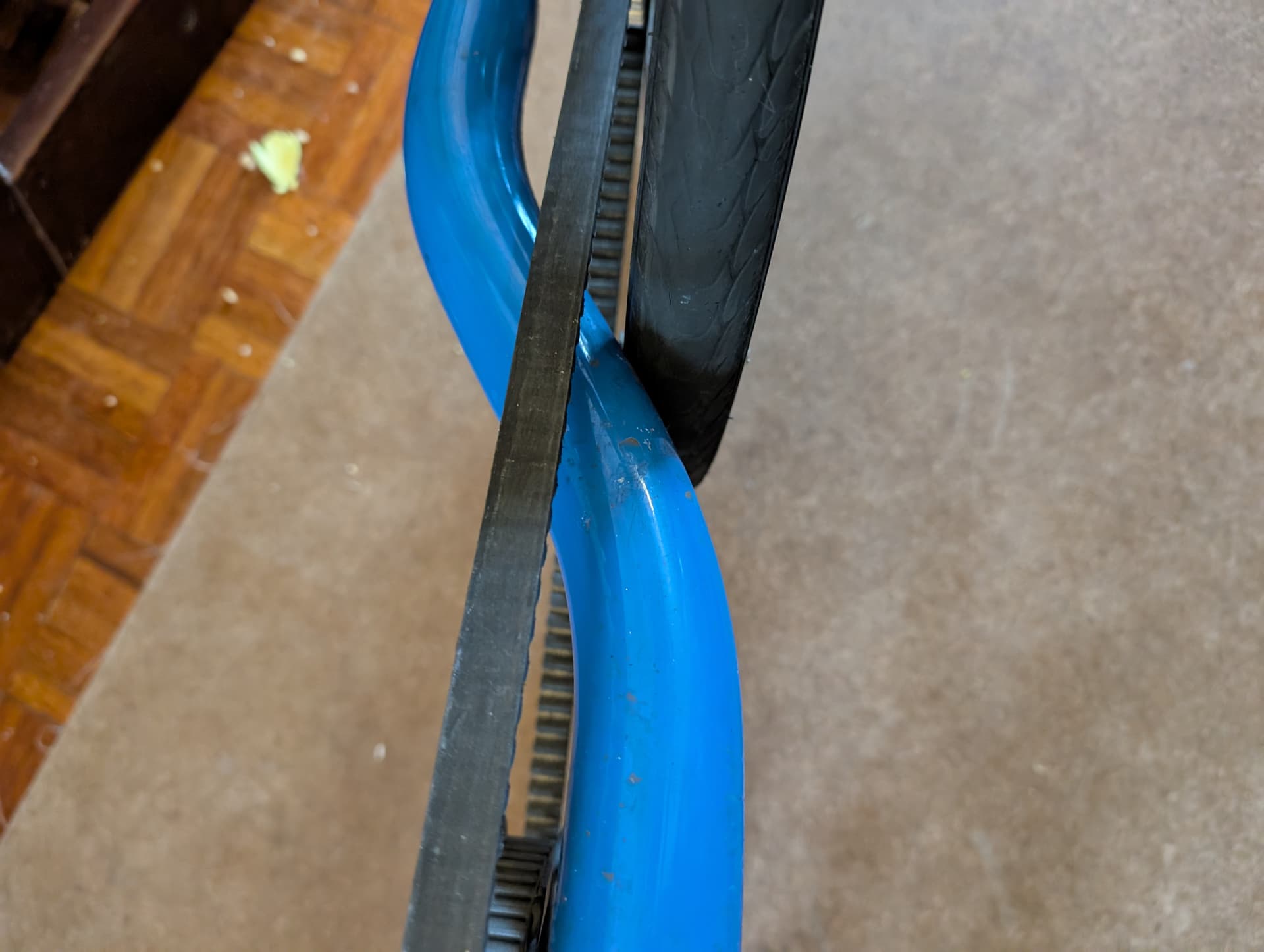

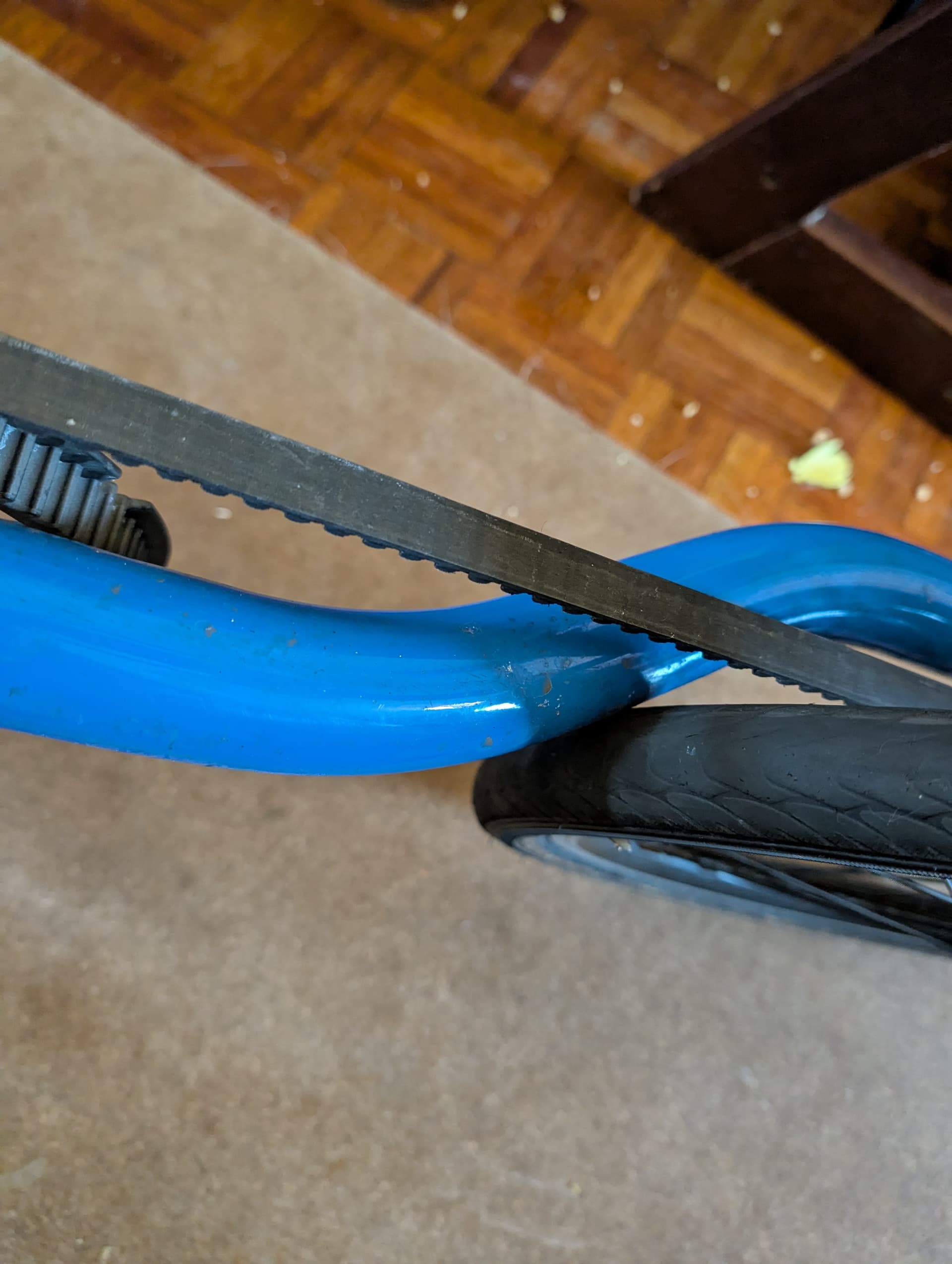

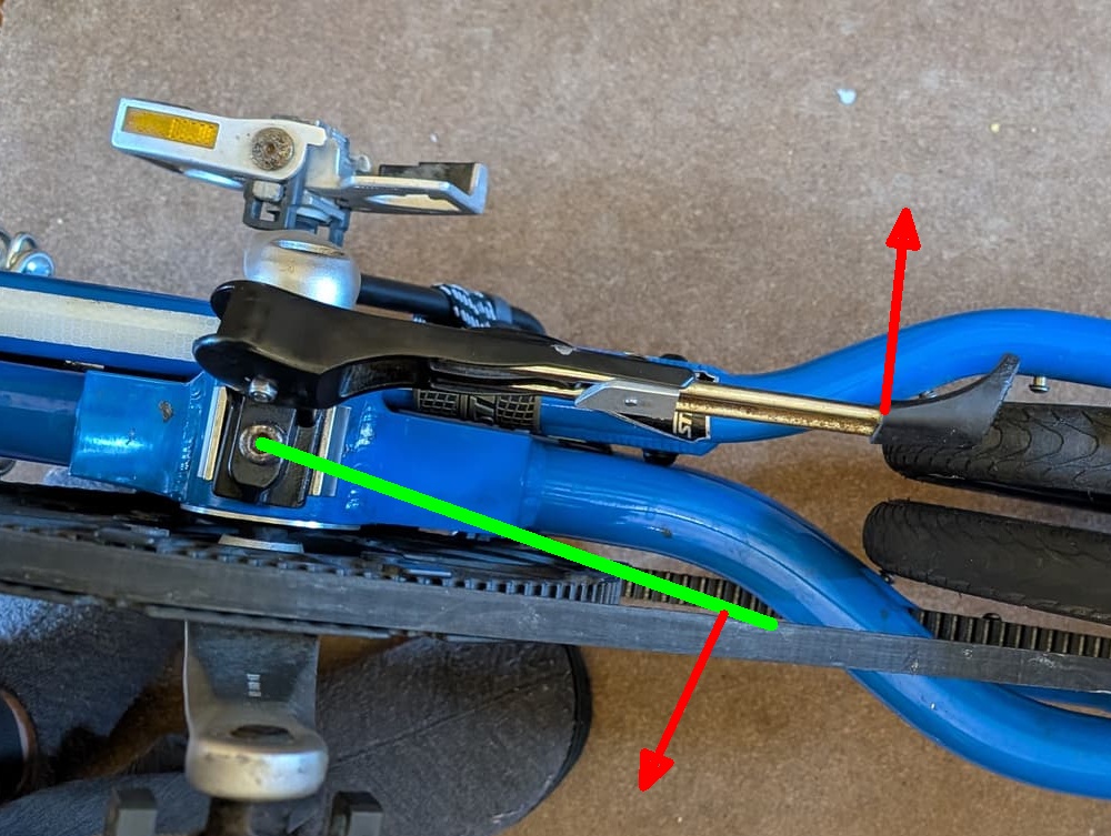

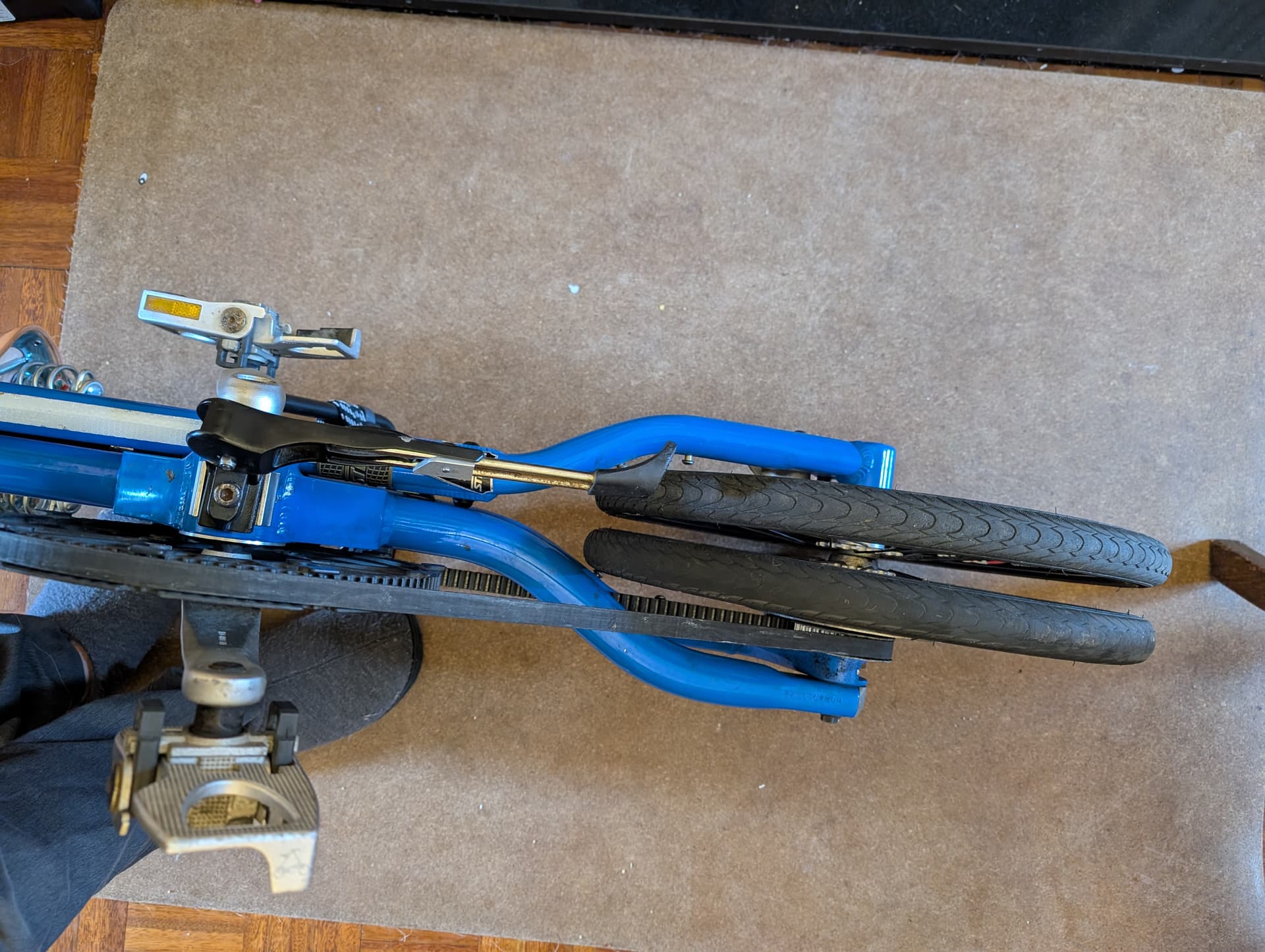

Thanks. I’ve added some photos that might help.
I think when fully folded the ‘locking’ of the horizontal frame section against the seat post pushes the frame away from the wheel.
It is almost like it has got bent?
This is white the frame ‘locked’ against the seat post

If you push/pull the wheel towards to/away from the tube by hand - how much play can you generate?
Very little without moving the horizontal bar from the plug in joint.
This is where the horizontal bar rests now when relaxed. Think it used to be more in line with the seat post before?
Very little must mean that the wheel bearings are OK.
Comparing with three of my bikes I must say - you are right! :astonished:
Sorry, but I do not have any explanation for that.
It is hard to believe for me that the tubes can bend - but of course, I couldn’t tell from images.
Mate, please do yourself a favour and look out for an experienced and nice bike mechanic!
The bar still seems straight. Is there anything in the join that might be pushing it in more than normal?
That’s why I was thinking maybe the belt could be dragging it in?
