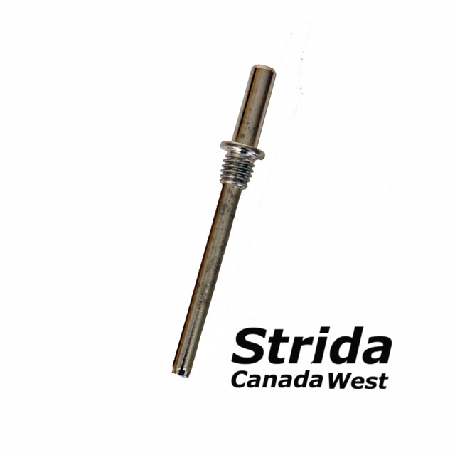

Obviously you are referring to the so-called “seat-pin” or “saddle-pin”, its key size is 2 mm.
The correct Strida part number would be ST-378 and it looks like this:

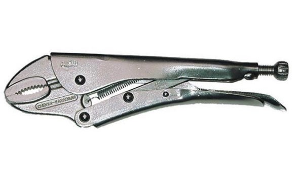

However, as you have to get it out first I’d recommend to loosen it with a pair of pliers like these:

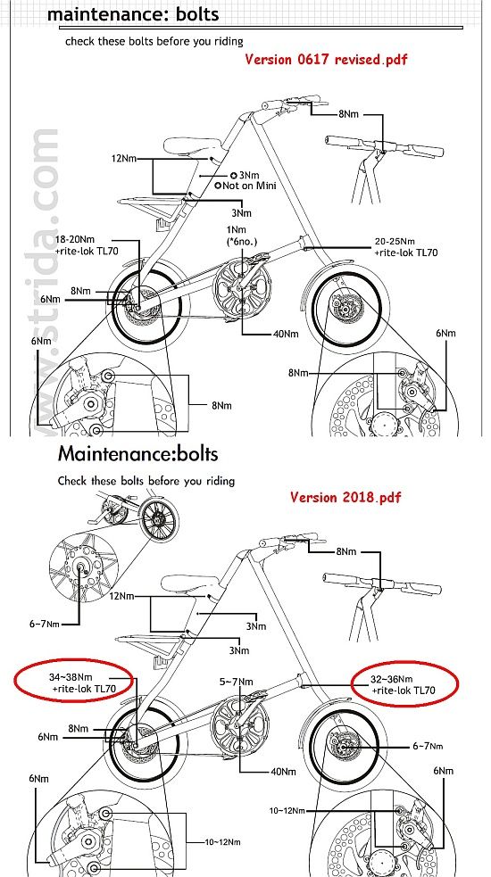

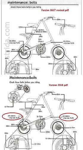

Recent example; for whatever reason some important torque amounts were changed at the manual, page 19.
https://drive.google.com/file/d/1OykZyoK2N1srOYRCjzhC2dhOzCEG56OB/view
Mark Sanders told them his concerns, especially regarding the rear hinge bolt, personally at the 10th June 2020!
I have also evidence that the mail was received, but there was no further reaction.

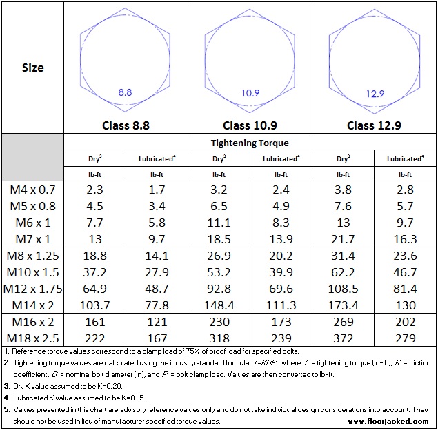

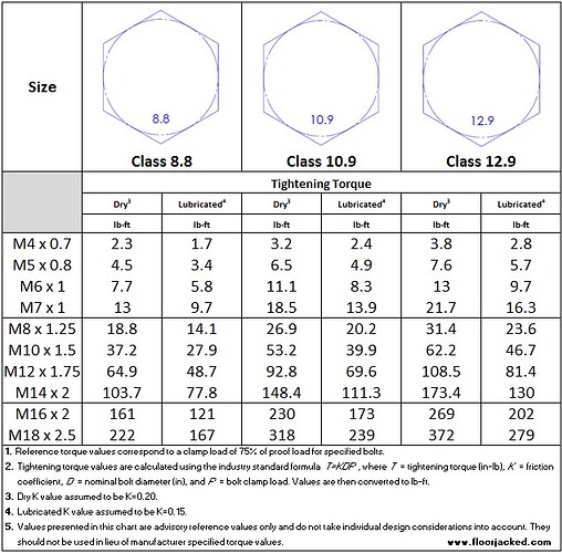

It is very easy to verify who is right, all you need is a metric torque chart :neutral_face:
