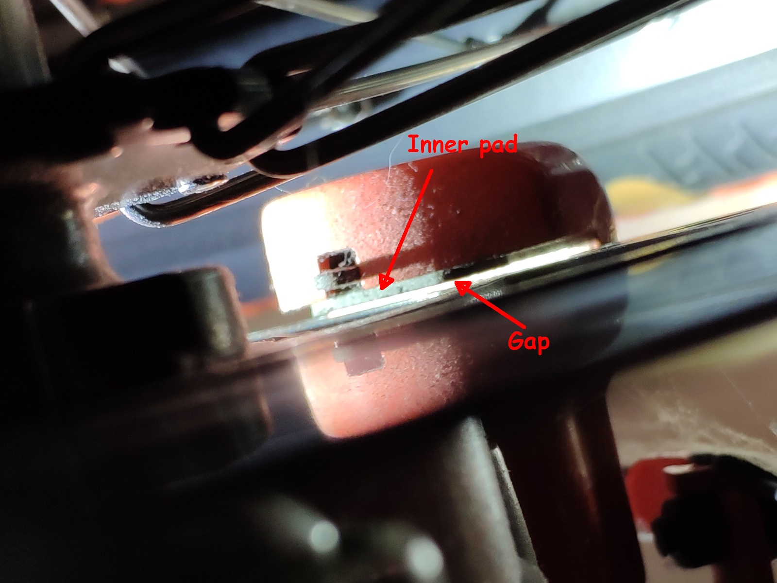

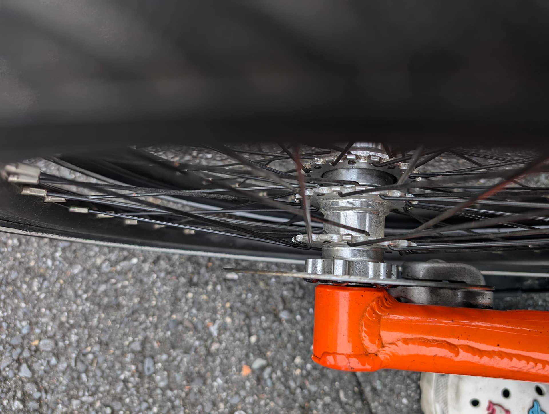

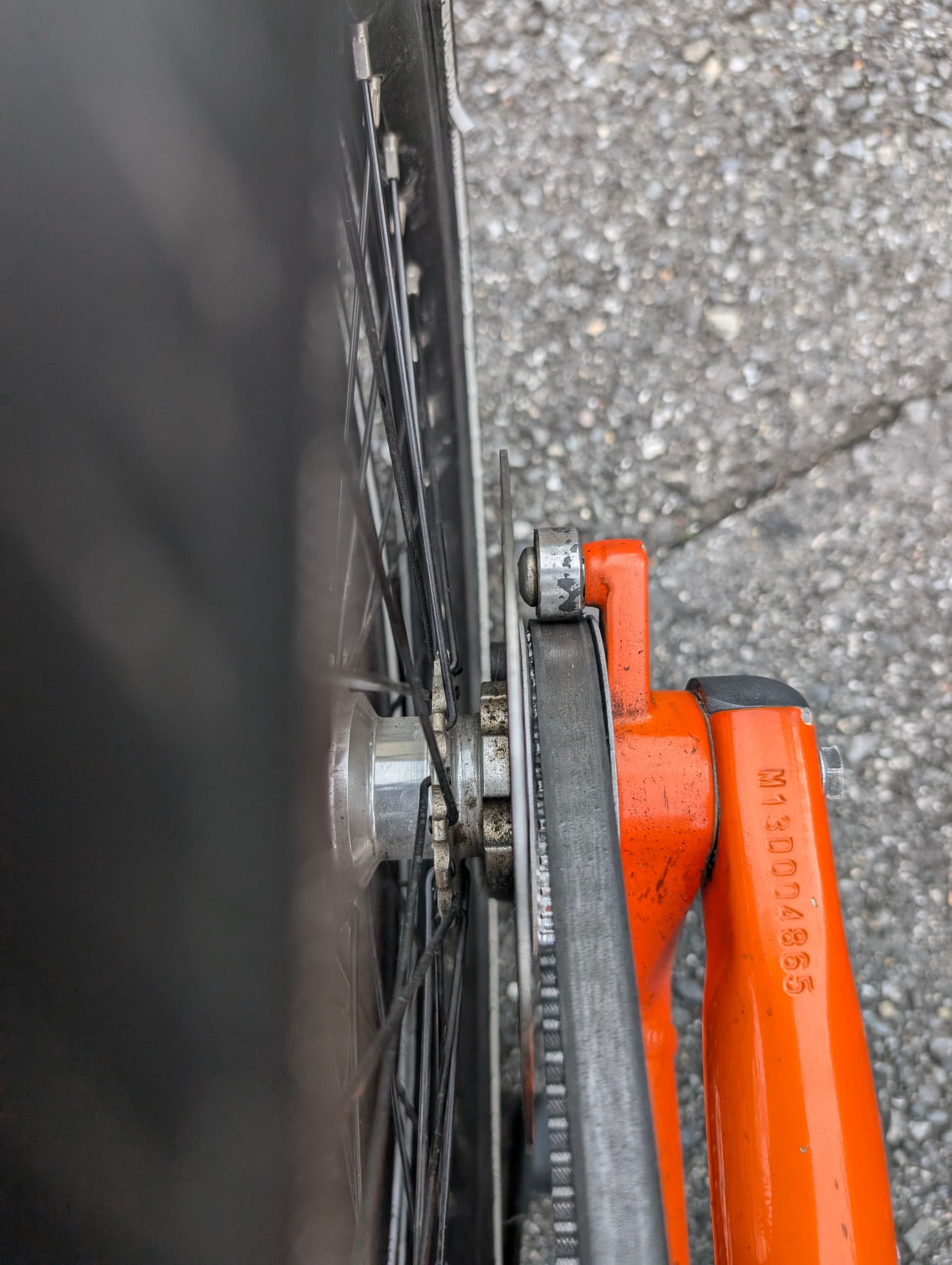

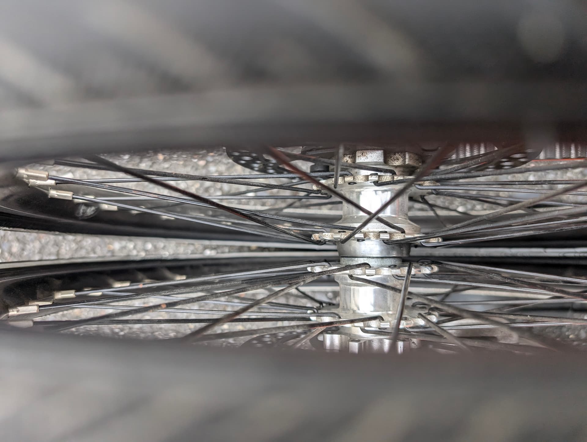

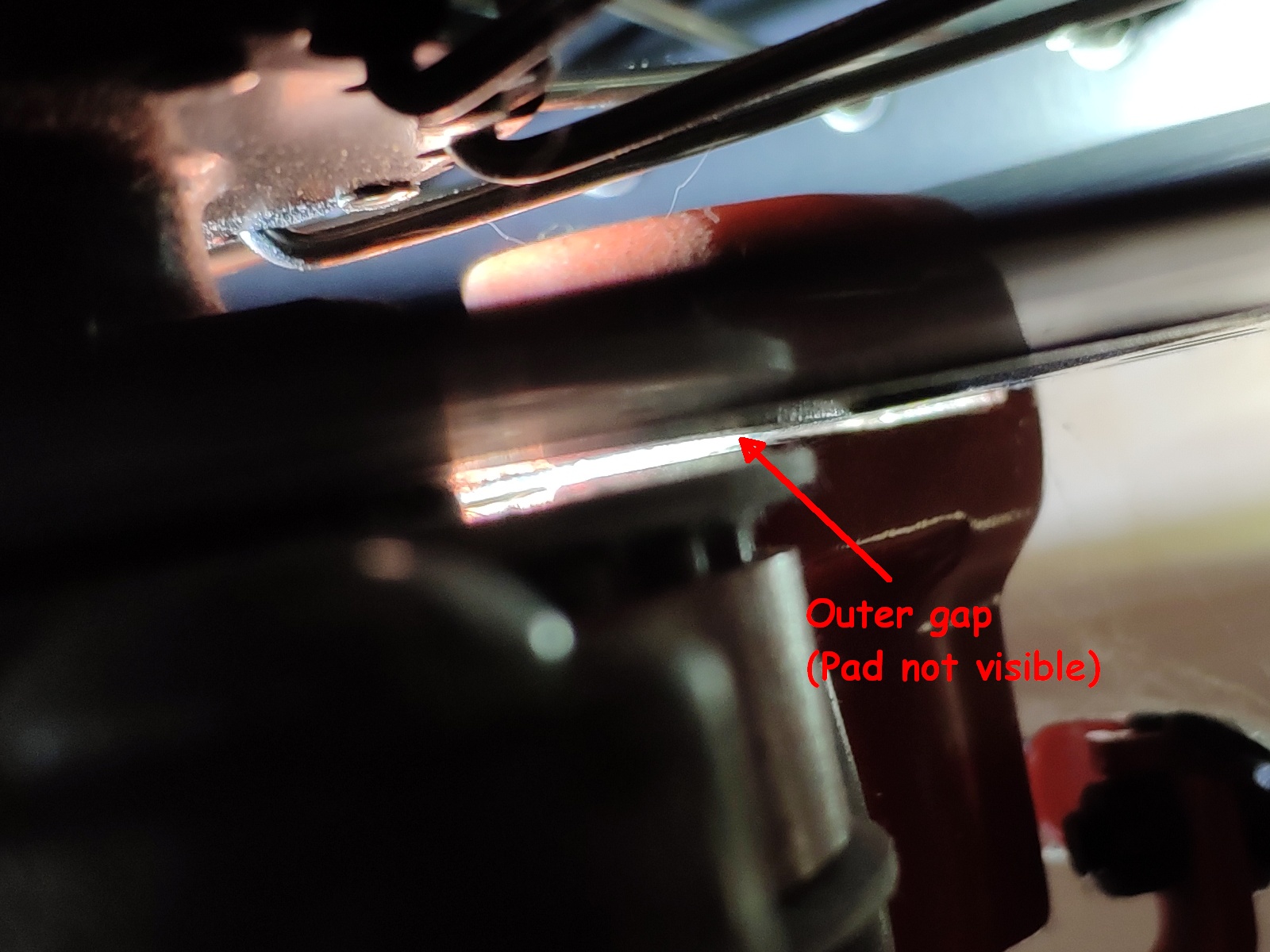

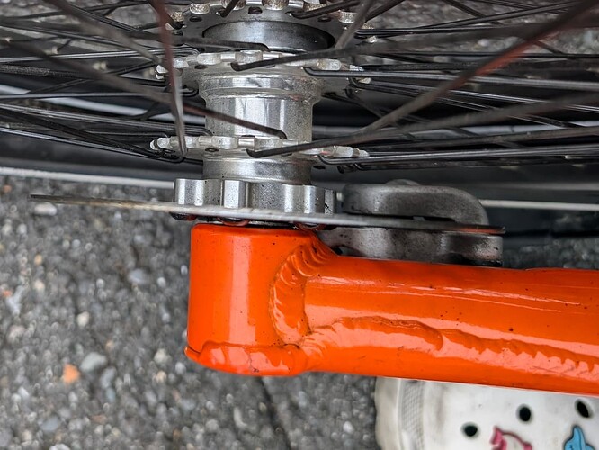

I guess so, maybe? If it’s okay, I’ll upload some photos of mine breaks space. Can you notice something wrong? Thank You.
Sorry, I can not see that on your images :thinking:
Hints:
Gap is hard to see.
Use an additional flashlight sideways.
