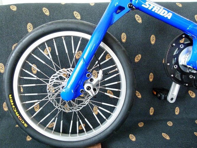

349 mm rims are available also with 36 spoke holes, matching to 18" Strida hubs :wink:
Ginkgo Veloteile
Looks great.
I found the scorchers by greenspeed today.

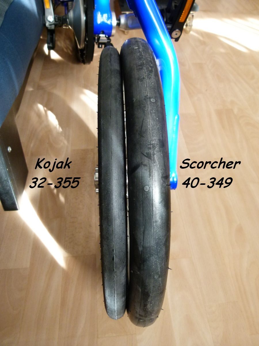

However i have mounted 44-355 to my strida and ordered a pair of 40-355.
The 44-355 barely fit into the frame as a front wheel and collide with the production fenders as a rear wheel.
6 mm in diameter could make a significant difference. Do the 40-349 scorchers fit under the fenders?
Regards: Klaus
Hallo Klaus,
I’ve never tried, but I don’t think so.
Moreover that, the fenders are narrower than the tyres, guess that would not work very well.
Also, I have to confess that Scorchers and the Jetset rims are a critical combination.
It is very hard to mount the Scorchers on these rims, and it is even harder to get them off again.
(Using now Schwalbe Marathon 35 - 349.)
