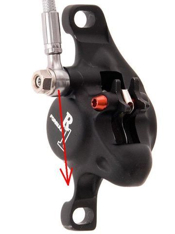

A common mechanical brake caliper cannot be used “backwards”.
(Admittance of the brake hose and brake caliper lever would change position).
BUT:
At some hydraulic brake calipers it should be possible to change the direction of the brake hose banjo:
What do you think? :question:

I guess that even calipers with fixed hose direction could be used - hose bending should not be a problem on hydraulic brakes…

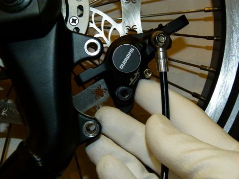

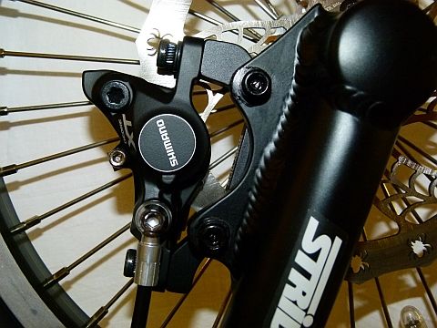

Therefore a short report:
(Strida upside down)
At the front there was no problem to mount a Shimano Deore XT BR-M785 caliper, using a 180 (!) mm front IS to post mount adapter.
(Shimano SM-MA-F180P/S).

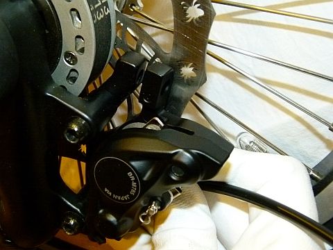

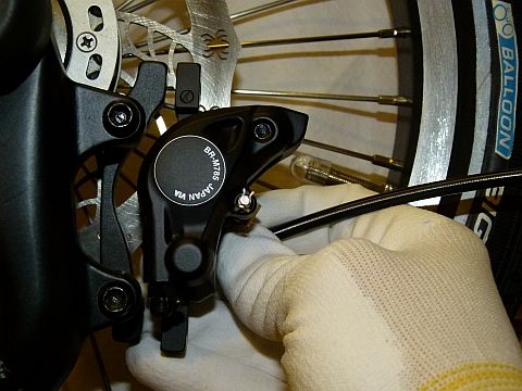

But at the back wheel it is simply not possible to mount the reversed caliper with standard adapters.
The reversion does change the position of the rotor cut of the caliper (in relation to the rotor).
Logical, no reversed caliper will fit at the right side of the wheel, it must be a mirrored caliper!
The last chance to fit a reversed caliper at the Strida’s back will be a custom adapter only.
(It has to be L shaped and relatively big, I mean…)
The adapter shown below is a normal front IS to post mount adapter,
(Shimano SM-MA-F160P/S)
which would fit perfectly for the rear wheel;
if the caliper would be mirrored ,
the angle of sight makes that visible (better 1024x768).
If Shimano, or any other company, does not supply a mirror caliper, this might be a long-term project…
